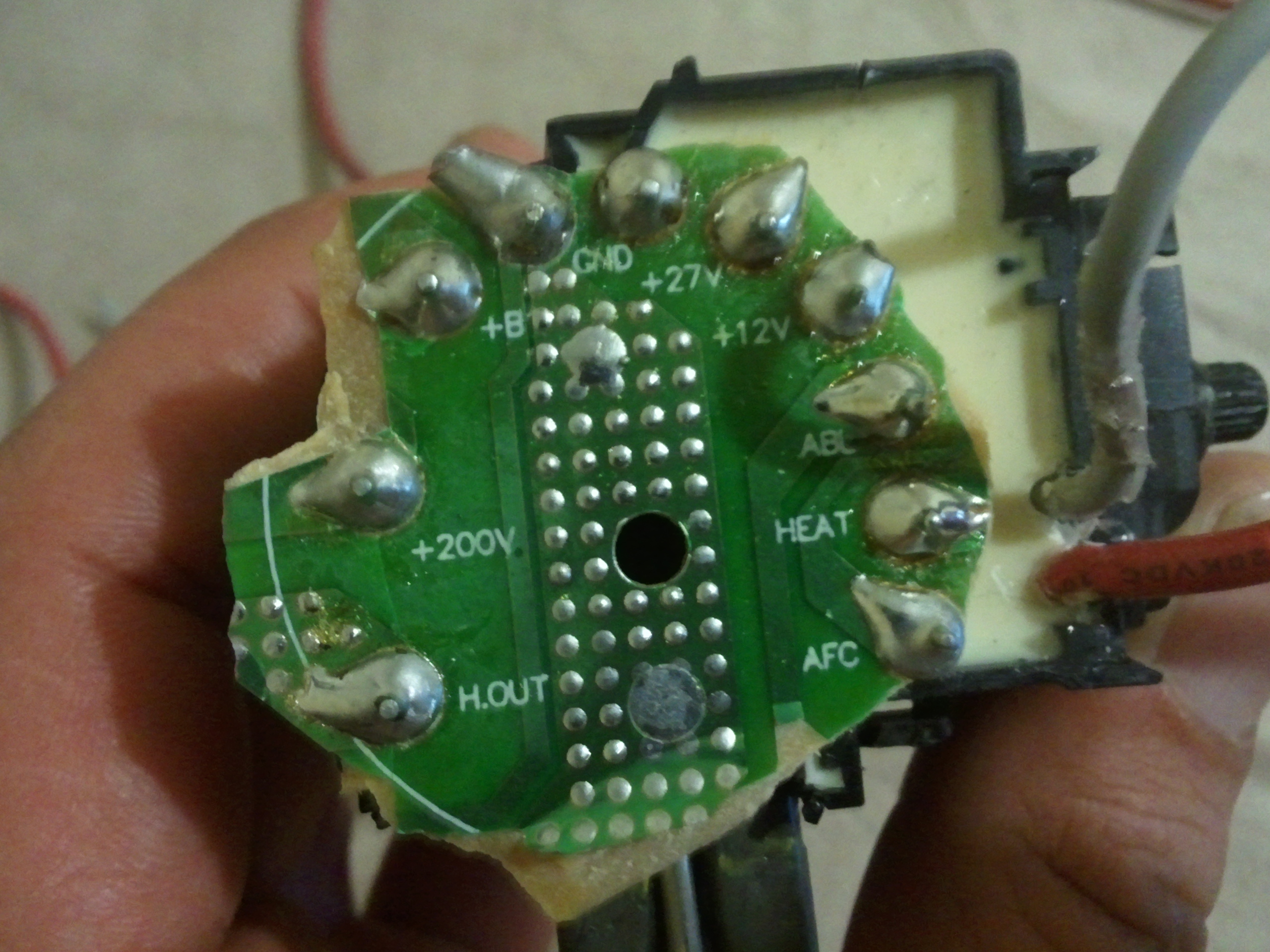

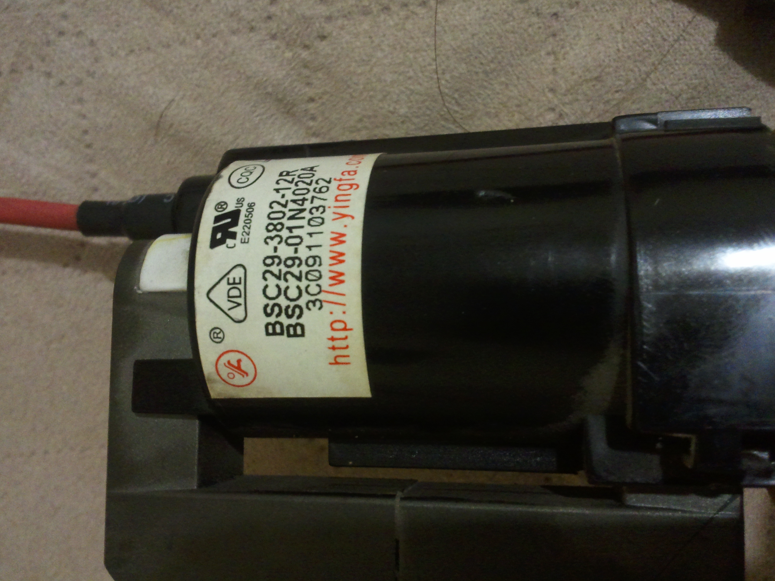

can some one help me out here, i need to know if the is a rectifier in this transformer and if it is which ones are connections?

Hi, lev77! Welcome to electro-tech!
That style of flyback transformer usually has a rectifier already in series with the output. It is often moulded into the case, so the connections have already been made, and it is difficult to remove the diode.

Thanks guys for ur replys. So i cant use just rectifier from this sistem. Is there any rectifier in tvs that i can use?if not wich recrifier i can use that as good as that one.
There aren't very often rectifiers in tvs that are rated for that kind of voltage. However, old-style (not solid-state) microwave ovens have a high-voltage (10-15kV) diode that makes up part of the voltage doubler circuit (between the transformer and the capacitor). Old microwaves are fairly easy to find, but if you decide to go this route, I wanted to make sure you know to be VERY careful around the capacitor. They can store lethal charges for extended periods of time. I once opened up an old microwave that hadn't been used for years, and when I shorted the capacitor I still got a pretty big spark. I'm glad I was using wire and not my finger! :D

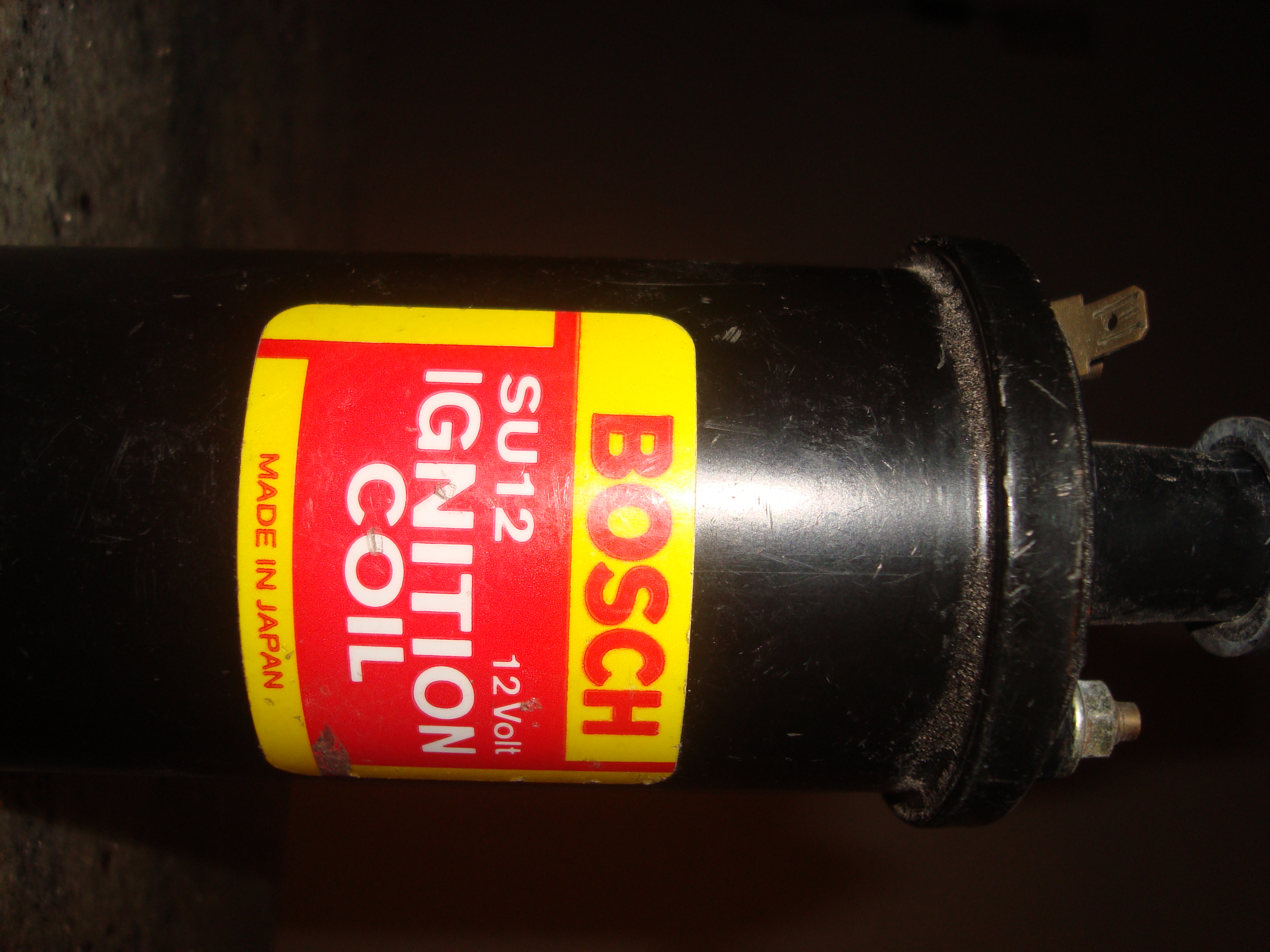

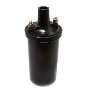

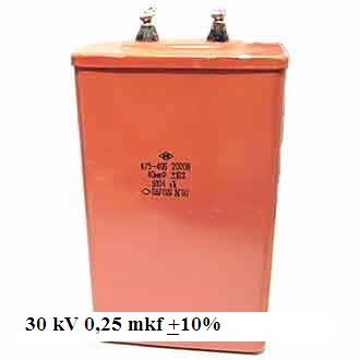

what im trying to do is connect car ignition coil to HV capacitor 30kv.. one on pic.
i been told i need a rectifier thats in flyback transformer.
is there rectifier that big that i can just go to shop and buy one.. if it is how big dos it have to be.

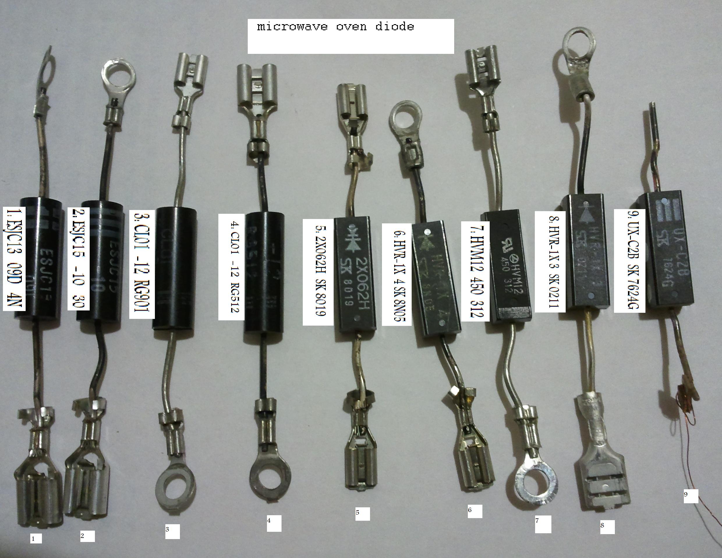

30kV is rather high for a single microwave oven diode. You may be able to find a few of them and connect them in series, with some high-value resistors in parallel to help to distribute the voltage, like this:
Here's what a microwave diode looks like:
DerStrom ill get as much diodes as i can but u have to help me out with high-value resistors which ones to get.
thanks
I believe the resistors should be around 1Meg, but of this I am not exactly sure. Perhaps someone else can help here? The wattage will depend on the amount of current your ignition coil is drawing/producing.

derstrom i got the diodes. which ones can i use and which high-value resistors do i need to get
thanks,,,,,
1 megohm, 1-watt resistors should work, but again, it depends on the amount of current from the ignition coil. You may have to go for 5-watt resistors. What are you using for the driver circuit?

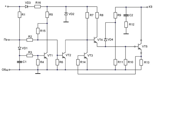

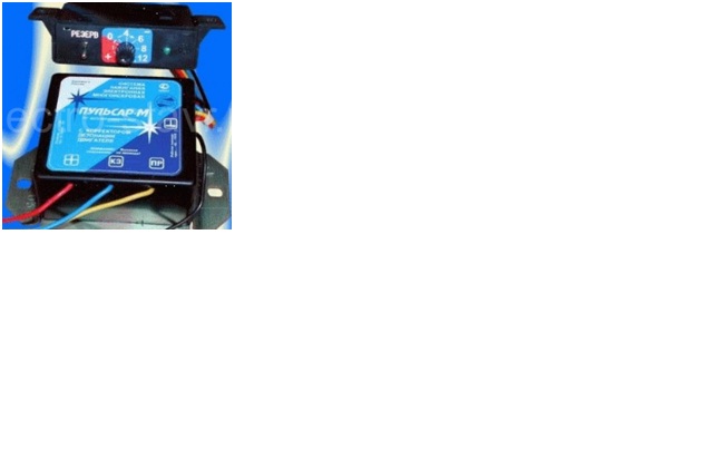

schematic of driving the ignition coil
this is what im useing to drive coil....

Wow--I've never seen a driver circuit like That before! Maybe you want to try a simpler circuit like this one:
It's much easier to build, and you can change the voltage and current of the output by using different-value capacitors.
ok, he's using a capacitive discharge unit to drive the coil. a simpler means would be a 12V relay wired as a buzzer, and the other set of contacts acting as an interrupter like the points in a car ignition.... derstrom? are you bucking for a Wile E as well? a 120V dimmer and line voltage? guaranteed to let the smoke out somewhere.....
lev77 what do you intend to do once you get that cap charged up? do you realize the carge on that cap will be lethal far beyond the charge on a microwave oven cap? i just want to find out how much you've thought this "project" out. "fireworks" is a bit vague. high voltage spikes from an ignition coil can be painful if you get bit by it, but high voltage stored by a large capacitor is much more dangerous (imagine one long continuous "spike" that continues to discharge through your body long after you're dead)..... i just want to know that you've considered the dangers here and take appropriate measures to keep out of harm's way... 30kV can "reach out and touch you".... i work at a shop that services microwave ovens that have similar caps charged to 5kV, and one tech literally got killed instantly trying to discharge the cap with a screwdriver......

I have used this circuit before do drive an ignition coil, and the coil handles the line voltage fine. The capacitor is very important, though. It is there to limit the current so that no real damage can be caused (either inside or outside of the ignition coil). I would recommend using no more than 1uF of capacitance, though, or else the coil might heat up.
In car ignition coils, since the primary and secondary coils have a high mutual inductance, you generally get a voltage spike of a couple hundred volts on the primary, anyway. The coils are designed to withstand this kind of voltage, so 120-240 volts from mains is not likely to cause much, if any, damage.
