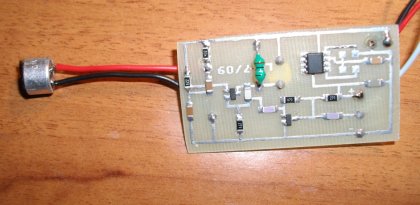

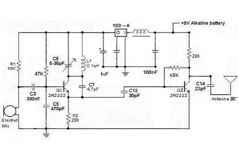

Hi
I did a small project so i can improve my knowledge and skills on RF and PCB designing without the use of any specialized software.. but seems i'm getting no where since i can't make it work as it is supposed to be.
initially i had oscillation problems with the regulator... the voltage was wrong..i could measure ~1,65V and i couldn't easily catch the transmitting frequency on my radio and if i did probably it was only harmonics and i could hear a high pitch sound which it was shifting up and down if i was touching anything on the transmitter.
The regulators i tried were 2 different LDO that i had available
Reg102-A
Reg101-33
https://www.electro-tech-online.com/custompdfs/2009/07/reg101-a.pdf
The problem persisted and i was thinking to try an LM2940-5 until i placed a ferrite bead in series with the (+) input power rail of the Reg101-33 and the problem i think is solved, the ferrite bead is a "Murata BLM31AJ601SN1L" which presents 600ohm impedance at 100 MHz and i had few available from past projects.
now i can measure 3.28V at the regulator output but still i can't manage to catch the transmitting frequency on my radio, for the LC tank i'm using an 100nH axial inductor so i can be sure that the inductance is somewhere near the needed value.

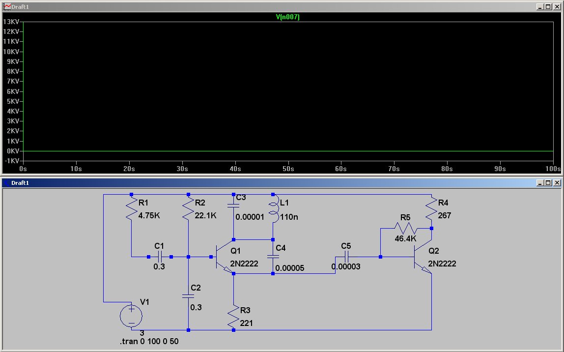

I also tried some simulations on Ltspice and multisim..but i didn't managed to make any succesful simulations..

If that's an LDO reg you're using, it may be one of the LDOs that require a resistor in series with the regulator output capacitor to 'spoil' the regulation a little bit. It does sound counter-intuitive I know, to put a resistor in series with a filter capacitor, but if the capacitor is too 'good', the regulator 'hoots' (oscillates) and the output voltage average is rather low too. Best check the datasheet for the LDO, it'll say in there whether there's special requirements for the output capacitor.
Another thing I notice, is isn't there supposed to be a second 47K between base and ground? (not just the one 47K)
The other thing that's frustrating with transmitter circuits when you're inexperienced, is that you don't know if it's making much RF power or not. Or what frequency it's on even. Most hobby oscilloscopes won't even register 100 MHz.
A great piece and a very useful piece of RF test equipment is an RF sniffer. Get a moving coil microamp meter, and wire two small schottky diodes in series, connected between the meter's + and - pins. From the centre tap, you can either touch it on the circuit and see if there's RF present, or you can attach a piece of wire and make a field strength meter so that you can tune for stronger signal.
When you're using a radio to monitor, ensure that the antenna is down, or unplugged, because you'll have a better chance of finding the 'real' signal, rather than blasting through an extended antenna and picking up an 'image'.
You must have a ground on the LTspice circuit.!

Best check the datasheet for the LDO, it'll say in there whether there's special requirements for the output capacitor. .
why don't you? :) it is suppose that i am the newbie here who can't even read a datasheet... that's why i gave you all this material and the links to the datasheets.
Another thing I notice, is isn't there supposed to be a second 47K between base and ground? (not just the one 47K).
can you explain further? first of all my schematic it is based on Audioguru's design...most of the circuit it is taken from his design.
EDIT:
Try this sim as a starter.:)

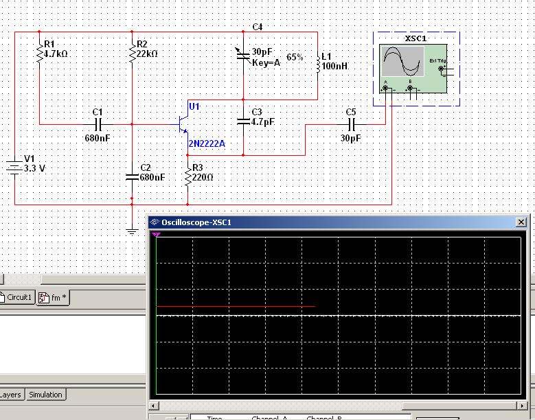

yea! i know about the ground.. but it was a messy simulation anyway... i couldn't find the right components and the appropriate values...Ltspace can't find the LM317 so your simulation also can't work correct. can you help on that?
i also tried on multisim but i had similar results...

This transmitter design is very very old. I built one very very similar 30 years ago, and back then it was the same 2n2222 as well. Over the years I'd expect it to evolve a bit, but I wasn't expecting to see the base of the 2n2222 with only one resistor. This circuit used to have a 10K up and a 10K down from the base in the 1970's. Perhaps it was done that way back then because transistors used to have varying hFE and they are more stable nowdays.
you mean something like that?
https://www.electro-tech-online.com/threads/help-with-rf-diode.34306/
Yes that kind of thing, but not 'done-to-death' with discussion, instead just try it for yourself and you decide what works for you. I used lead-ended germanium diodes (OA81 I think) and they worked fine. If I wanted more sensitivity I would clip a piece of wire to the meter - as well as the wire antenna. I never ever had low sensitivity problems. I used one of these to develop a UHF TV transmitter in the early 80's.
REG101 series says it's a: 'new generation LDO that has this magical DMOS pass transistor, to give freedom from output capacitor constraints'. It also says it doesn't need an output capacitor. Yeah yeah ok, but that's down-hill with a wind behind it, that'll under be good test conditions.
But reading between the lines, if the output current is only a few mA (note there's 0.65 mA idle current), it probably goes unstable if the output capacitor is more than 10 uF, and if it's 'too good' a capacitor. Fix this by replacing any fancy tantalum with some crappy electrolytic instead, or if you can't find one put 0.1 Ohm in series.

Maybe RF is reaching the reg and it's over-reacting to it? Just maybe. If so, a ferrite might save the day. Also, is the supply rails of the oscillator decoupled together, decoupled separately from the reg IC?
920 mV is reasonable. You can get more or less RF by changing this voltage by altering the 15K. You usually get as much RF as you can.
No not a freq meter, an 'absorption wavemeter', it's basically a sweep tunable LC, with a meter, they typically have plug-in coils to cover a large range. A grid dip meter is kind of an AW with an oscillator added, with some means of measuring variations in power. A freq meter is still a good tool to have.
The 4.7 pF cap can be an adjustable capacitor.
decoupling is as you see it on the schematic... should i add one more ferrite? where should i add it?
i forgot to tell you that the actual resistor on my circuit is 270ohm i don't have 220 so i'm using the closest value i have.
If Audioguru was around...he would say "change regulator!!" but i don't see the point of doing that... let's say i'll get an LM2940-5 then the oscillation will dissappear?!
I'm a Texas instruments child... i'm expecting one day they offer me a job! i'm kidding! :D
Before you condemn the LDO, stop the oscillator (press a 0.1u capacitor between E & C of 2n2222) and see if the LDO voltage becomes normal, that way you'll know that it's RF doing it.
I don't see much decoupling across supply rails, near the osc. The RC tank has some RF currents and there's no path for them to the 270 ohm, except through the LDO maybe.
Try put ferrite just upstream of decoupled osc. supply rail.

Before add ferrites I think you ought to temporarily stop the oscillator and see if it's RF that's making the LDO malfunction.
By upstream of 'something', I mean at the power supply line that feeds the 'something'. Upstream as in water flowing in a river. I hope you know what I mean.
I would put a ferrite in the power line feeding the oscillator. The ferrite to attenuate the RF reaching the LDO.
I'm puzzled why there's surface mount components used on your PCB? I am sure leaded components work just as well and they are easier to use.
You know I normally recommend people to do as much as they can to design an unfamiliar RF circuit first, before doing a PCB for it. If it's leaded components, you can even develop this circuit on 2 short lengths of tinned copper wire screwed to a peice of wood! Then when you're happy with the design, you can do a PCB. Some people I know prototype the PCB layout on blank sheet with tinned copper wire as though it is etched tracks.
i did it... but usualy the voltage is steady at 3.28V (since i added the ferrite bead i've noticed it to be more steady) so even if i stop the oscillator.. i can't know if something is wrong while the voltage stays steady.
ok i'll do that... i'll add one more ferrite at the regulator output.
this is my first design using SMD components i'm very new on PCB designing.
the general idea of the circuit it is suppose to be tested and working long before i learned it's existance... :D also a year ago i have done a thru hole version on a strip board (excluding the regulated power supply and the second transistor) which kinda worked...but the frequency was rolling all the time and it wasn't useful to play with.
Now i'm taking that old very basic circuit and i'm improving it with the ideas taken from Audioguru design.
but as a project has no use other than the educational part, though it gets very dissapointing if you can't make it work.
