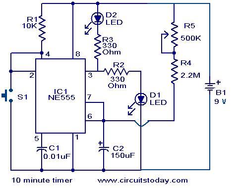

Okay so I built the circuit to the exact specifications for the 10 minute timer but I am having trouble getting it to work properly. Now I am fairly good with tracing a board but I have never built one from scratch till now and I would like to get this to work. Here is my issue I hook up the 9v battery and the LED turns on when I hit reset it goes out but the other LED does not show that it is in timing mode unless I swap the LED's leg, but when I put the LED to normally on it does not come back on after the timing process is over. How should I go about getting this to work? Also I would like to make it ground another momentary switch and automaticly reset.
Here is the schematic I used.

There should be no connection between pin 2 and pin 4. R1 should be connected between +9v and pin 2. Pin 4 should be connected to +9v.
Ken
After the Reset button is momentarily pushed, and then RELEASED, pin 3 of the Timer goes high for the timing period. When you initially connect the 9V battery, the timer comes up in the triggered state, just like you initiated a new timing cycle by pushing the button.
If it is the lower LED that is lit, and never goes out, this means the timer never completes its timing cycle. That could be caused by excessive leakage in the 150uF timing capacitor. If the current sourced through the ~2.5meg timing resistor is less than the leakage of the capacitor, the timing capacitor will never charge high enough to terminate the timing cycle.

KMoffet: the circuit is fine as drawn.
K7ELP: the circuit is fine as drawn; if connected as you show, you will instantly vaporize one or both of the LEDs when you hook up the battery!
Stare at this sim of the posted circuit.

MikeMI,
Thanks for the correction. You are correct.
