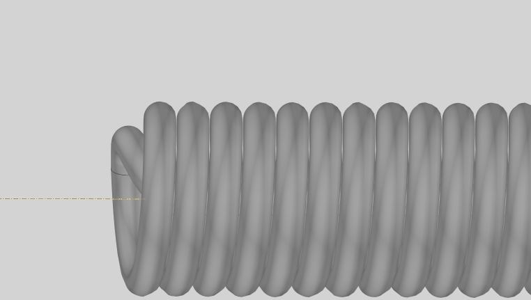

Another thought. If you wrapped wire around closely, you get a contact pattern as shown here in red
If you oversoldered it -- whilst it wouldn't wet the ceramic -- is would fill (some of) the voids and achieve a far greater area of contact.
Maybe overkill, but you might as well try and get as much of your current to flow through the ceramic, rather and just generating local hots spots.
Its a thought.

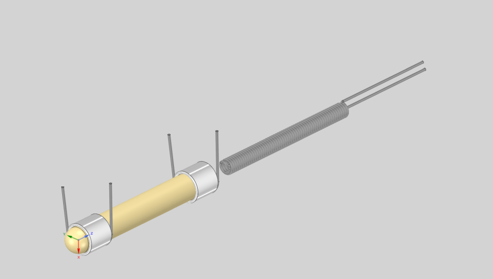

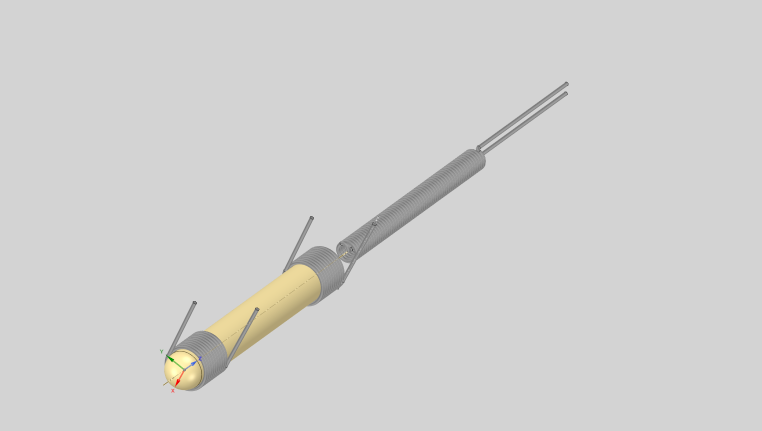

The NiChrome won't get the YSZ hot enough to incandesce on its own, but it should get it hot enough (~600°C) to allow the YSZ to start conducting enough that the (resistance to the) flow of current through the YSZ will start raising the temperature further.
If I were attempting this, I try a setup something like this:
Heater element consists of 60 turns (around a 2mm former) of 0.5mm NiChrome wire + 20mm & 50mm tails for a total length of 536mm.
(It's intended to slip inside the cruciple.)
The wire has a resistance of 5.551Ohm/M so the resistance of the coil is 2.9786 Ohms. Call it 3 Ohms.
If you put 30V through that you get a current of 10A; and a power disipation of 300W or 300J/s.
The cruciple has a volume of 420.97683694mm³ and the ebay page lists the density as 6.02g/cm³ giving it a mass of 2.5342805583788g, or 0.002534kg.
According to this pdf YSZ has a specific heat capacity of ~45000 J/Kg*°C. (At 600°C)
45000 * 0.002534 = 114.03J/°C
Which -- ignoring losses -- means the heater element ought to raise the temperature of the cruciple by a bit under 3°C per second.
So around 3 minutes to reach 600°C.
At that point, you'd probably need to switch the heater off and hope that the YSZ will conduct enough to continue raising the temp.

Thanks this is very helpful, especially with the picture.
Two things to note:
  1. The turns of the heater coil should not be touching. They aren't in the picture, but it doesn't look that way at the angle posted:
  2. The solder blobs are left over from the earlier post -- where they were intended to improve contact when measuring resistance at lower temps -- would drip off long before you reach 600°C; so best omit them if you see progress to higher temps.
Two things to note:
  1. The turns of the heater coil should not be touching. They aren't in the picture, but it doesn't look that way at the angle posted:View attachment 132863
What kind of wire would you recommend for the ends?
According to **broken link removed**20:80 NiChrome wire should be good to 1200°C continuous, So I'd use that there also.
