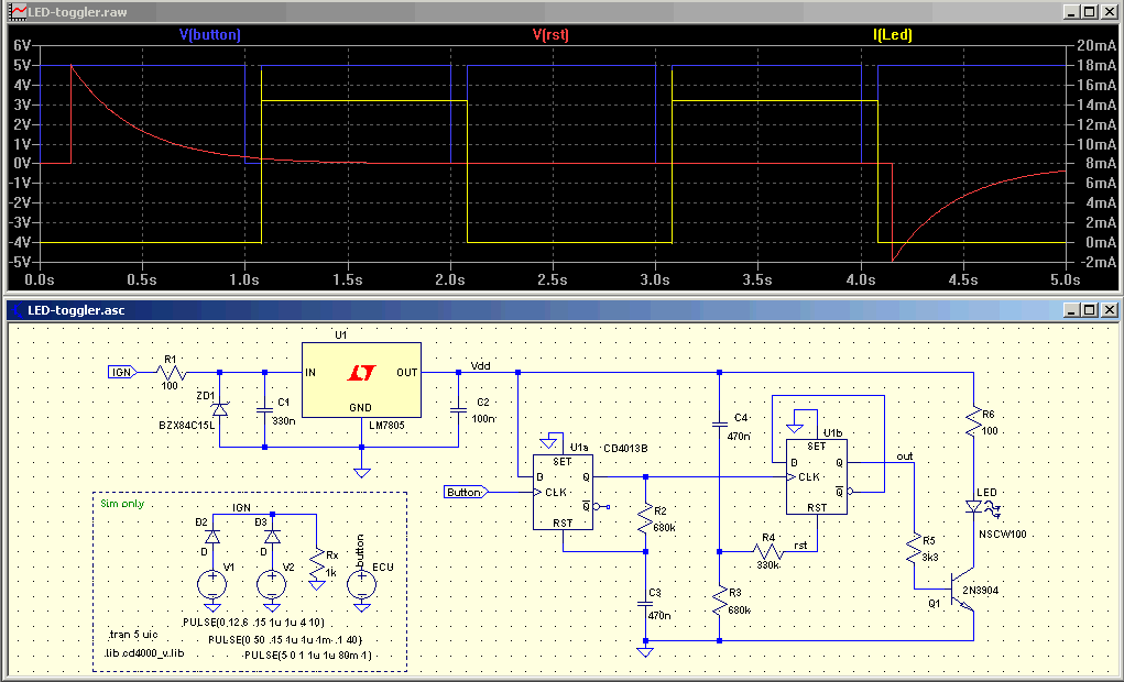

This should in theory do the trick, but there's no absolute guarantee it will stay in sync with the transmission mode shifts. I've modelled the effects of 50V voltage spikes on the nominally 12V supply taken from the ignition switch. R1/ZD1 suppress these. When the ignition is switched on, C4/R3 provide a lengthy reset pulse to U1b so that the LED is initially off. Button presses are assumed to provide a 5-0V clock input to U1a which is configured as a monostable to suppress switch bounce.

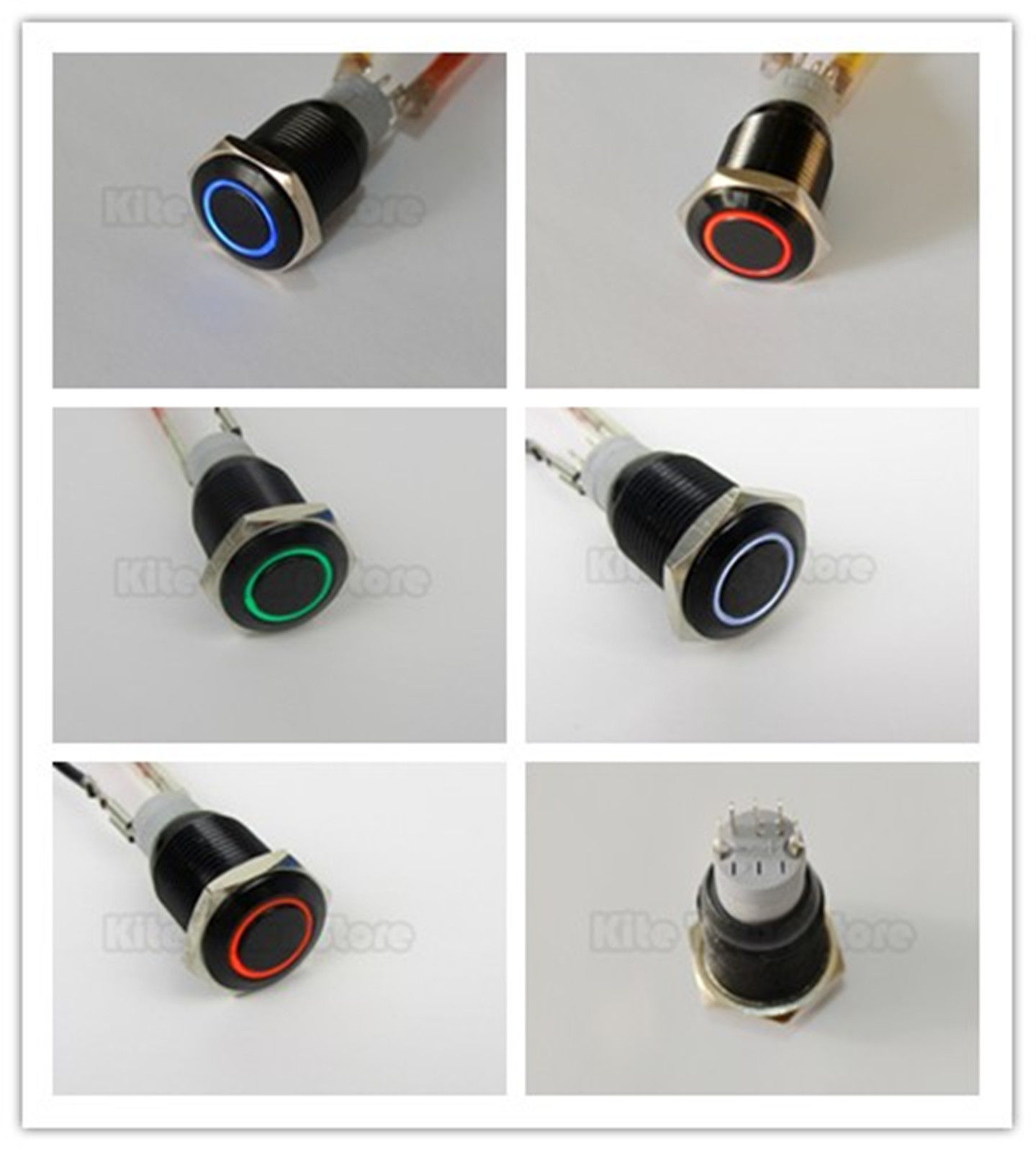

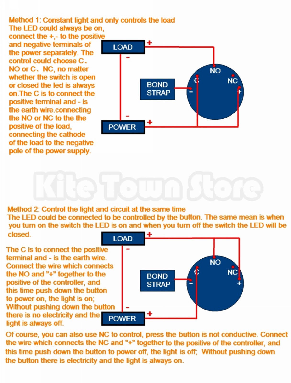

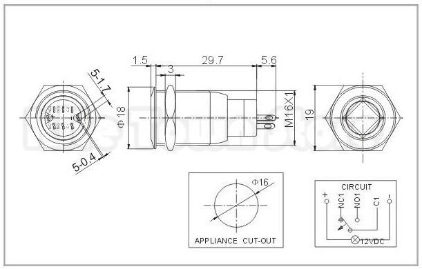

I found this switch on EBAY, **broken link removed** It's a momentary switch with a built in LED. Do you guys see this as usable component that might merge what I'm after and what you're coming up with?
That link gives no info about the LED rating :(.
• QTY: 1PC
• 100% New and high quality
• Head diameter 18mm
• Button diameter 10mm
• Hole size required 16mm
• Depth inc contacts 35mm
• Metal button [Flat Head]
• Switch rating: 3A/250VAC
• Led voltage: 5-12VDC
• Contact Configuration: 1NO 1NC
Warning:
The normal operating current for the LED light is 20mA.
Please aovid using the excessive current to cause it too heat then it will reduce its service life.

The illuminated switch in post #38 looks suitable, as does the ELM411 (provided switch bounce is less than 25mS). How do you envisage the comparator being used, KISS?
BTW, as I read the ELM411 datasheet it is the power-up time, not collapse, which is critical to the reset?
