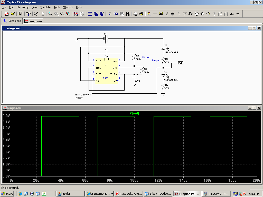

Timer
Interesting.. Bad circuit.:mad:
Remove 33k and .1 ufd.
Move pin 7 to junction of 1 meg and 100k
Tie pin 2 to pin 6 and to junction of 100k and 220 ufd.

Ron, he is not trying to build a free-running oscillator, he wants only one cycle. The RC network on the TRIG pin is there to trigger the 555 ONCE as power is applied.
