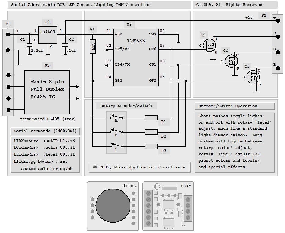

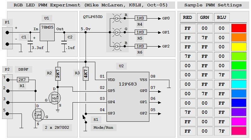

Hi guys,
Sorry I'm so late jumping into this thread... I've been kickin' around some RGB LED lighting ideas and came up with the concepts below but I'm sorry to report I have not even finished building the first one yet (grin)...
Regards, Mike
