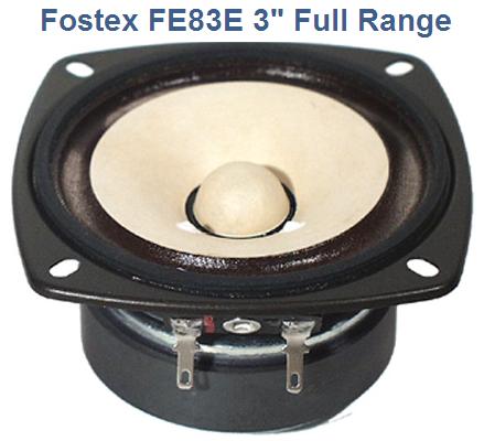

I got a pair of decent quality full range speakers of small 3" size. They are rated at a power handling capacity of 10W at 8Ω. A large magnet for its such a small size and looks almost like this:**broken link removed**
..so it can handle bass freqs at decent level and even trebles also. Further I have constructed suitable enclosures using thick speaker wood at mediate size.(40cm l, 12cm h, 15cm w box enclosing both speakers left n right).

Post the manufacturer's name and part number of your tiny speaker.
It probably resonates at about 120Hz in free air and the resonance will rise to about 150hz in your box. Then it will not have much output below 150Hz.
I think it is a Fostex FE83E with a resonance in free air of 127Hz. Its datasheet shows a pretty big complicated dual-chamber bass reflex enclosure for a response down to about 100Hz.
A few hi-fi speakers and sub-woofers go down to 20Hz.
Many sub-woofers and most woofers go down to 40Hz.
Almost any speaker goes down to 60Hz.
A cheap clock radio goes down to about 150Hz.

Nope. image is just for general idea of the thing. No manufacutrer or partno. on it but 8ohm 10W. It should be rms spec'n I believe. tda2030 is a good choice.How about the treble boost and bass control for this device?I will use 12-0,2A X'former. Is that ok?
The Fostex speaker I posted costs $31.20US each ($28.08US each for a quantity of 10).
It is rated at 10W music power or 5W continuously.
Yours is probably a cheap Chinese copy.
Without a datasheet then you are just guessing.
Absolutely right audio guru :D:rolleyes:
It is not even new pieces. I would tell 1year old I got from another person for a cheap price. Leave all those matters and I would tell they are excellent anyway.

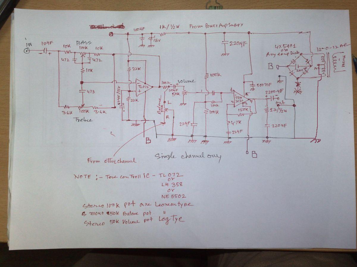

8Ω,10W. That's all written over it. I will use tda2030 with above mentioned power supply. Help me out to design a treble boost and bass control prior to tda2030. Thank u.
hi musicl

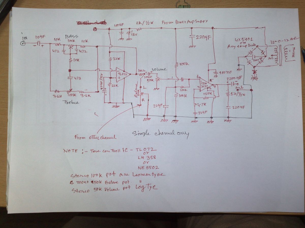

I give u a complete integrated power amp circuit build with control amp it provide bass/treble boost/cut and volume control with balance, I show u one channel only pls duplicate for other channel.it looks complicated but this is the simple.no part u cannot simplified i build it many years ago. i remember the sound was very clean and good. if your power supply have good power and have big mfd u feel good punchy bass on its power limit. don't expect high power from this amp it deliver at least 9 watt/ch at 8 ohms this is more enough for your requirements and sweepable for your 8 ohm 3 inch spkr. if any problem don't hesitate to mail me at atahak@yahoo.com

Hey thanks ataul for ur wonderful circuit, the same what I was looking for.
My Questions:
1. Amperage of X'former. Is it 2A ok? or 3A u mean. Mention clearly n plz tell me the spec'ns of the speakers u have used with this set up.
2. You haven't spec'd pin nos of tl072. But, sorry I haven't have any experience with it. Plz do specify.
3. 15V(?) zener before op amp. Will it induce breakdown noises to the amp.
4. 1N4007 is ok for rectifiers. Thank u.
1.You need at least 30w x'former, I use Chario cinthea200.it is lo efficiency speaker.you may use any hi efficiency spkr at least 8 inch driver.
2, tl072 accordingly pin1-output1. 2-inverting input1 (-) 3- non inverting input1 (+) 4-ground. 5-inverting input2(-). 6-non inverting input2(+). 7-output2. 8 positive
3. zener is no problem
4. 4001 no serious problem
ataul, yes! n I think u got my requirment clearly..a punching kid bass form the tiny 3" genius ;). Does tl072 op amp contains one more amp for stereo second channel.
Fostex recommendation for a double bass reflex enclosure hit on my head now..let me see for an updated system design. What kind of enclosure u used. MDF enclosure will be nice n u have any idea on lamination or painting. I couldn't understand the sound absorbent spec'd on he Fostex FE83E recommendation.
I check on datasheet of tda2030. In ur diagram there is no any 4001 diodes connected as in the datasheet. What's the purpose n y u omitted those :confused:
I've attached ur circuit modified for my second doubt. Is the ground goes to centre tap of X'former n tda2030's pin3 goes to -12V? Is it correct or wrong?
If I use 12-0-12V,3A. Will tda2030 handle this current.
Don't use a lousy old LM358 opamp (noted on the amplifier's schematic), it has crossover distortion, has a very low bandwidth and is too noisy.
A TL072 is a dual opamp with low noise, low distortion and wide bandwidth.

Your conversion of the single-polarity-supply amplifier to a dual-polarity-supply amplifier is full of errors.
If the single polarity amp posted by ataul is ok, then I'll follow it. It seems to be very nice. Any advantage for dual supply over single supply? Then y can't u correct me on the schematic posted by me and tell the errors!

PS: So I can use single tl072 as dual amp for stereo. right?
