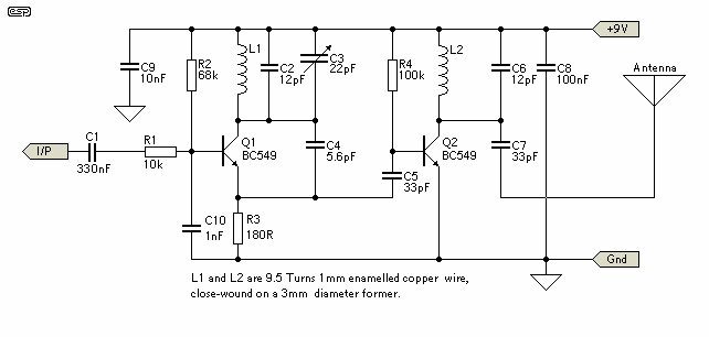

Try this transmitter for external audio inputs. It looks like a good design but I didn't try it. As audioguru told, the frequency instability is there for this type of simple transmitters.
Hi Valve,
You posted Rod Elliot's fM transmitter. It has an RF amplifier so that the antenna is isolated from the oscillator so its frequency stability is pretty good, but without a voltage regulator its frequency changes slowly as the battery runs down.
It doesn't have pre-emphasis (treble boost) because a mic preamp is used with pre-emphasis with the transmitter.
True.
So the required pre-emphasis circuit for both mic and line-in along with a detailed explanation for this cute transmitter is here. Thanks for Rod Elliot!:)
