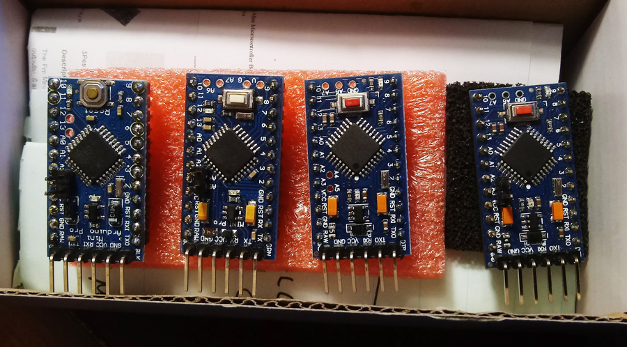

Yeah, well that is a point. When the ProMini 3V came out, the rationale was that it is cheaper - see https://www.sparkfun.com/products/retired/9220
But cheaper is relative. It is small and the clones are very cheap. These are the four that I have left:
On the far left is the original from Sparkfun. The two clones on the right cost US$1.80 each, free shipping from China. I just looked at the receipt from Dec 2017 - maybe they have gone up $1, don't know, but that is pretty darn cheap.
They are small and once in the project, you can still access them for reprogramming (see https://www.electro-tech-online.com/threads/yasp-yet-another-silly-project.157779/).
Once I got used to them, I just never thought about having to use the USB/Serial connector much.

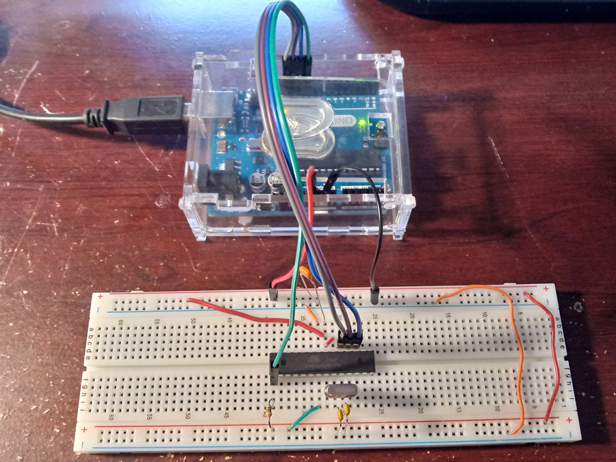

One thing though. If you roll your own ATMEGA386, you may not want to mess with also building on board USB capability. For example, for this one:
I burned the bootloader with an UNO
Thereafter, I used the same USB/Serial board to program it from the IDE:
I followed exactly and it took me about an hour from start to burned bootloader to programming a flashing LED. There are other approaches and many such articles, but I like that guy's writing as it is carefully clear.

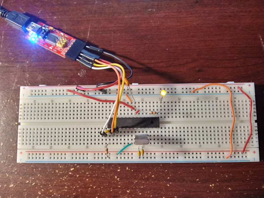

I'm using an FTDI UMFT230XB USB/Serial breakout board.
Datasheet: https://www.ftdichip.com/Support/Documents/DataSheets/Modules/DS_UMFT201_220_230XB.pdf
It turns out that its serial I/O operates at 3.3V. I put it on my scope just to make sure. Since 3.3V logic levels are TTL compatible (min 2.5V for logic 1), I expect it should work with most 5V boards too. I've already used it with ESP-01 boards which are 5V.
I'd picked up several of these USB/Serial adapters a few years ago for an unrelated project, but they work fine for programming Arduinos. The only drawback is the lack of DTR line. So, I have to manually press the reset button on the pro-mini.
Anyway, the good news is that I've uploaded a sketch to the pro-mini without any problems. So now I can get on with my main project.

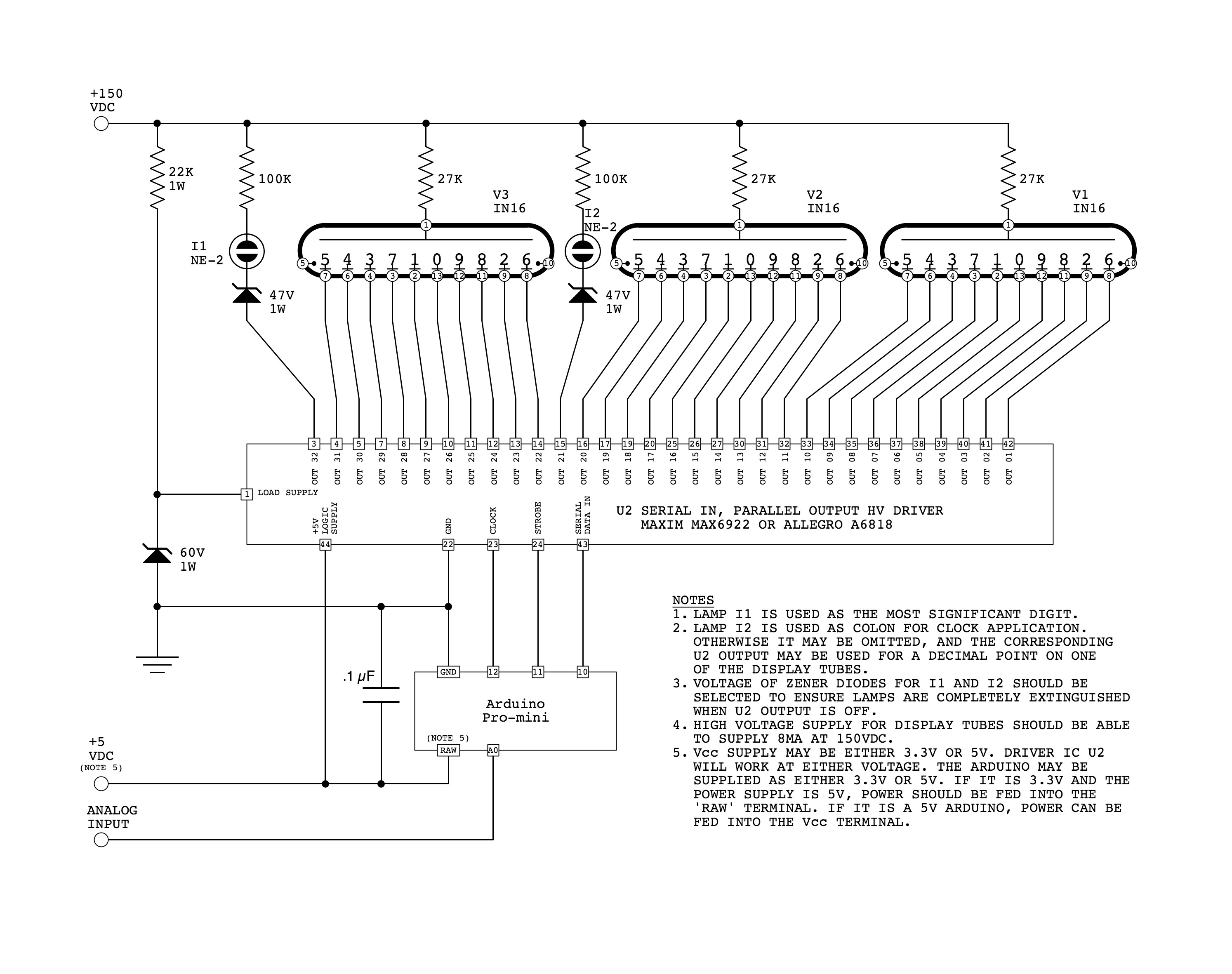

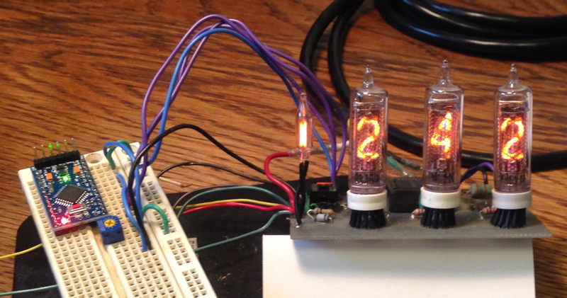

Last night I did some programming. I'm a bit rusty, programming in C, and got tripped up with function calls that have no parameters. I was unaware or had forgotten that, unlike some other languages, even if your function call has no parameters, you still have to include an empty pair of parentheses. I'd left them out, and the compiler didn't flag it as an error. So, it took a while to track down.
Anyway, it's working now. I'm using the Arduino to interface to a MAX6922 32 bit HV driver to operate a 3½ digit Nixie display. The MAX6922 is actually a source driver, but the outputs can sink enough current to drive the Nixies.
This display had been controlled by an 8 pin PIC. I just popped the PIC out of the socket, then plugged the data, clock and strobe lines from the Arduino into the PIC socket. The Arduino reads analog input A0, scales it to 0..1999 and displays on the Nixies.

No, they're not VFD's. VFD's would have a blue or green display. I used Russian IN-16 nixies. As I mentioned above, the MAX6922 is "intended" for VFD use, but it works fine as a sink driver for nixies as long as the current isn't too high. See the attached schematic for the wiring I used.
