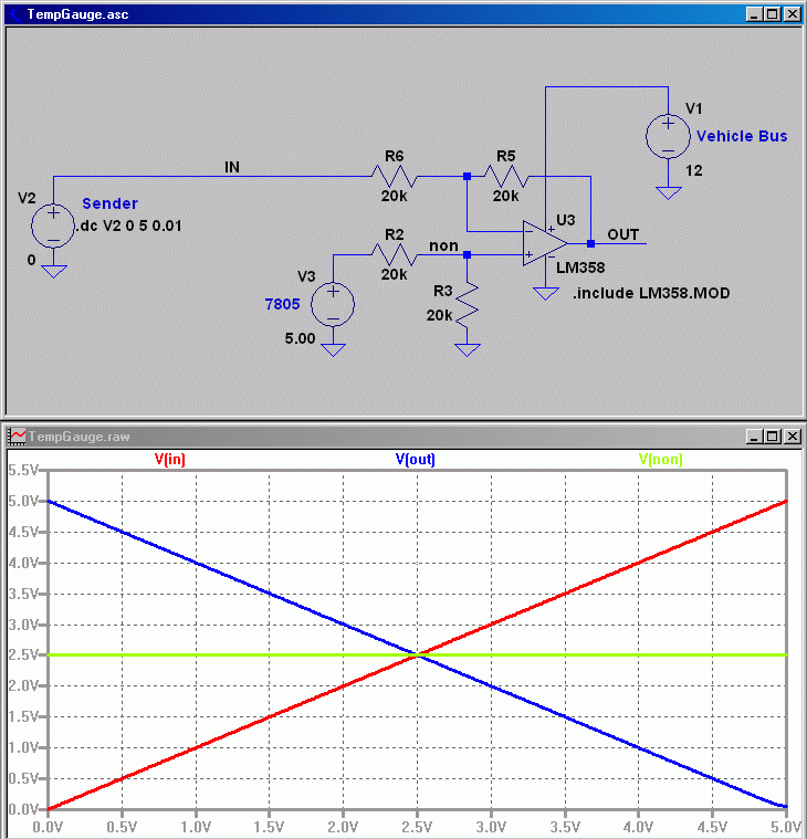

Give me a two-point fit of the function that you want; i.e. A Vin=X Vout and B Vin=Y Vout, and I will generate a single-supply opamp circuit.

Vin +5.0 : Vout 0
Vin 0 : Vout +5.0
That's trivial. A single LM358 configured as an inverting amplifier (R1=R2) with 2.500V at its non-inverting input will do that. I'm inferring from the schematic that you linked to that there is a 5V regulator, so just put a voltage divider (with two equal resistors) across the 5V, and tie the tap to the amplifier's non-inverting input.
Note that the LM358 will not pull quite all the way to 0.000V, but it will get within 10mV, or so. So that the LM358 can pull it's output all the way to +5V, you will have to power it from the unregulated vehicle's voltage(12 to 14.5V), presumably from where you are powering the 7805. Remember that even a crummy opamp like an LM358 has a Power Supply Rejection Ratio (PSRR) of ~95db, so some noise on the vehicle's electrical bus will not introduce any disturbance to the LM358's output.

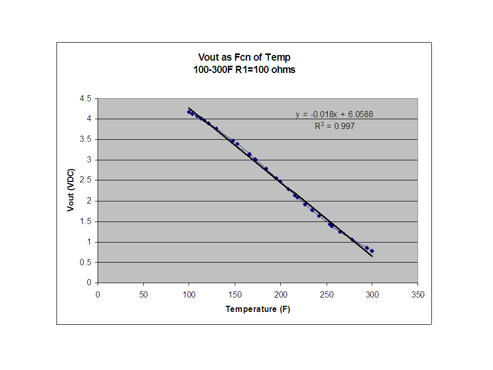

The sender is a resistance device - as temp rises, resistance falls.
At room temp, it's resistance is approx 1.2K. At 300 F, it is 20 ohms.
Because the LM3914s expect VDC signals, I mounted the sender in a voltage divider where the other resistor is 100 ohms. I can't switch the placement of the sender and the 100 ohm resistor since the resistor body is ground and there is no physical way to connect a resistor between it and ground. (That would have made this whole discussion moot.)

Voltage variation as function of temperature
I see I'm not the only one that uses EXcel for things like this... Looks linear enough. You seem to have found the sweet point where the pull-up resistor value gives optimum linearity. I derived that equation once...
I just messed with R1 until I got a decent linear fit.
