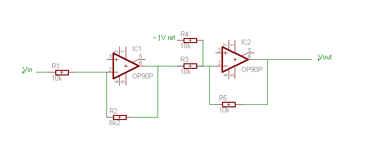

if you can live with:
INPUT OUTPUT
0.5	1.365
1	1.78
2	2.61
3	3.44
4	4.27
then it is possible
Those results fit a
y = mx + c
ie
output = 0.83x + 0.95
and y = 0.8x + 1 is pretty close as well
so you will need a gain and a summer

hi
do you have to have any more connection to the chips?? like earths and lives??
and also how do you get a -1v ref on a 5v dc circuit??

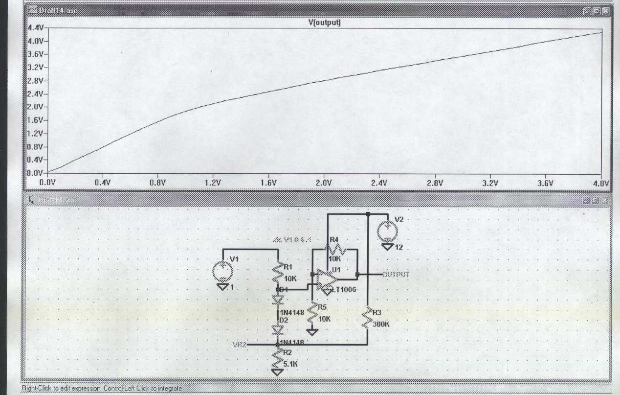

hi
this looks great but can you explain a bit more
i.e
v1 =
v2 =
vr2
and the wiring up of the lt1006
and as for the table
the voltage across the bottom = in
and the voltage up the side = output
the r1,2,3,4 are ok
the d1,d2 are ok
many thanks
scott

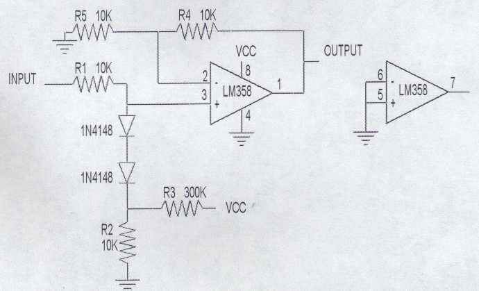

V1 is the input voltage that is swept from 0V to 4V. V2 is the supply voltage, in this case, 12 volts. Vr is just a test point.
I re-drew the schematic to be easier to understand. VCC can be 6V to 12V, altho you will have to tweak R3 at other than 12 volts. The LM358 is a dual op amp, only one is used.

voltage increase
hi
the pic is great
if i was to run a car wiring the charging voltage in normally 14volts
would this all still be ok
and to change the gain from say 50%-80%
could i fit a variable resistor to increase the output?

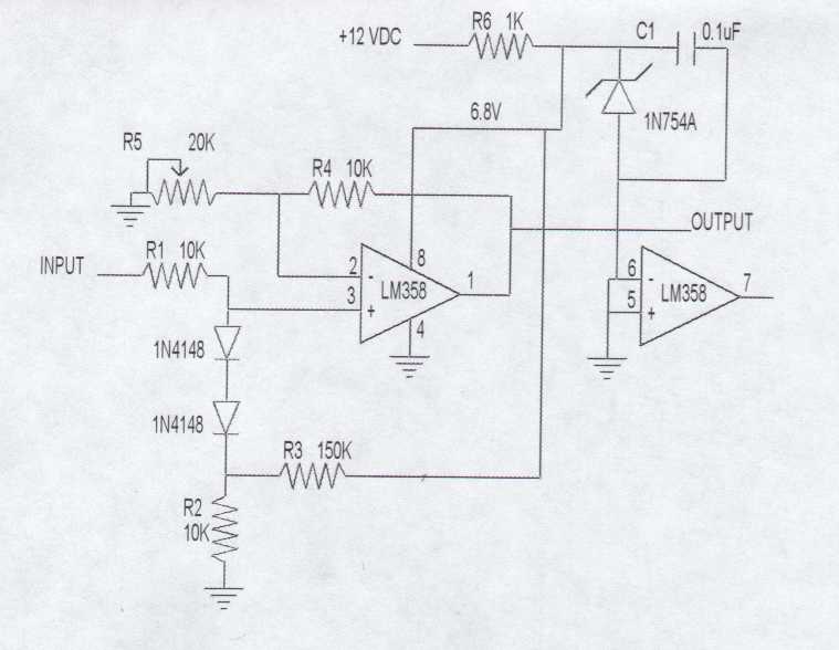

The op amp will run out of head room if run at 5 volts and will not reach 4.3 volts output. The error running from 14.2 volts will be minimal but you will want some noise filtering. Keep in mind that voltage spikes on the 12 volts can reach 60 volts. A 6.8 volt zener and 1K resistor would be good insurance. In that case, use 150K for R3.

so if i put A 6.8 volt zener and 1K resistor on to the vcc's (contact both together) zener 1st then the 1k resistor
this would down size the voltage to 6.8volts ?
then put a 150k resistor on the r3 this would compensate for the zener and 1k resistor ?
where would i fit the variable resistor to change the % of gain??

The 20K pot will allow the gain to be reduced to 1/2 or increased to infinity (not really, but more than you would want). If you want to reduce the gain more, use a larger pot.
