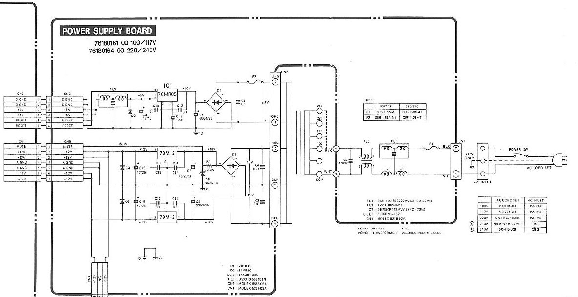

This is from the service manual. Can anyone tell if it's a switcher or not?
Looks like linear regulators at the output of the power transformer with taps on the transformer for the different voltages.
Thus I would start with the 240V tap first which will minimize stress and power dissipation in the regulators. Only go to a lower tap if you have problems with its operation.
No it's not, it's a conventional supply - presumably Greece is 220V?, but 240V should be fine. It will make very litte difference either way, as the outputs are regulated anyway.

As it's a regulated supply, selecting either tap should make no real difference.
