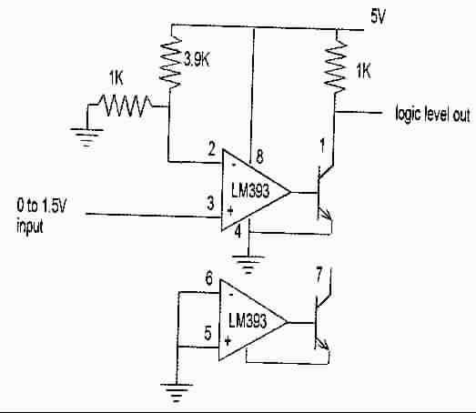

I have an output of 1.5 volt. Need to make it a logic high - should be at least 3 volt.
I was thinking of using aviable 5volt and maybe a darlington transistor in between. Any one that has a schematic for such?
Roffee
This pulse amp will do it:
