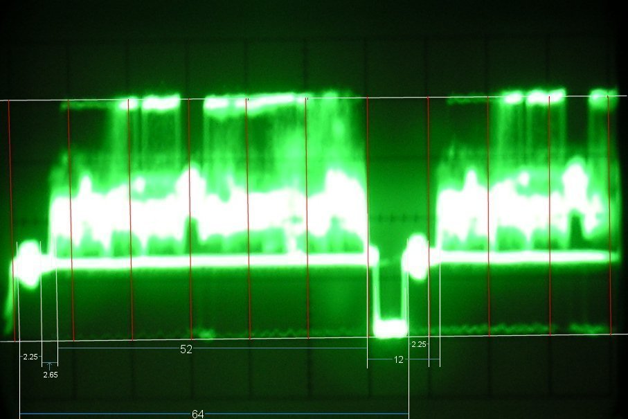

I have ordered the chips I'm gunna need, but so I can fully understand the theory behind this I looked a bit deeper at the PAL signal. Below is a photo of my 'scope connected to a PAL signal, along with the theoretical durations I have found of various sources (which seem fairly accurate). The horizontal sync signal is clearly visable here and is well documented as a negative pulse, lasting 4.7 micro seconds.
However I cant find any information about the level or duration of the vertical pulse. I'm assuming its the same negative level of a longer duration? I can't examine it on the 'scope due to the triggering. Anyone have any ideas? Is there an official specification for the PAL standard as this would be useful, I cant find one or anything referring to one however?

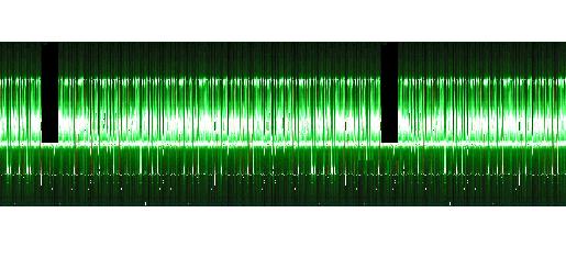

i havent done any of this stuff for years,
but from what i recall,
this is pretty much what the video signal looks like,
i had always thought that the absence of signal
was detected as a frame pulse ...
but i could be wrong, its been a while.
this pic was just drawn up as an illustration,
its not a real scope image.
Just to show how i remember the frame pulses ...
Regards, John :)

No, the frame sync pulse is a negative going pulse, just like the line sync pulse - but longer. You should be able to trigger any scope from the frame sync pulses (most have a 'TV sync' setting which helps), set the timebase to 5ms/cm or 2ms/cm.
Unfortunately my scope does not have a TV Sync setting (Its very old >30years!) It always seems to trigger from the same place, which seems to be just a line sync pulse., If I set it to '-' edge triggering you can see the duration of the negative period, which measures at around 4.7 micro seconds (a line sync pulse) and if you set it to '+' edge triggering, the first thing you can see is the signal rising up from a negative, not the duration of the negative period. I have also played around with manual triggering, but as the frame sync is the same level as the line sync, i think I'd be lucky to find it. 313 line sync pulses to every 1 frame sync pulse.
Viewing it on a 'scope is not essential, I just cannot find and information on its actual duration, which would be useful!
