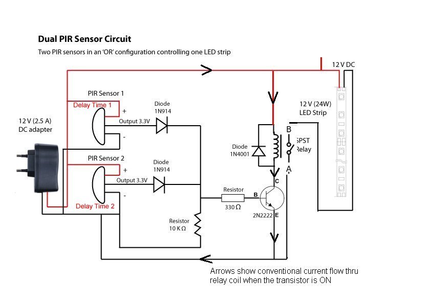

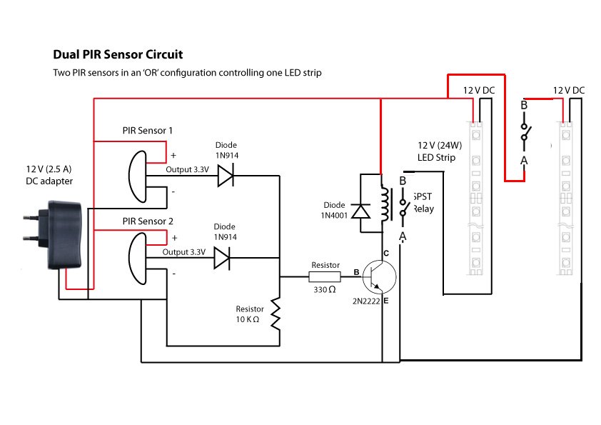

Neeed some help with dual PIR sensor circuit
I have added the relay 12V supply link, also shown an option for switching the 'high' side rather than 'low' side of the lights.
E

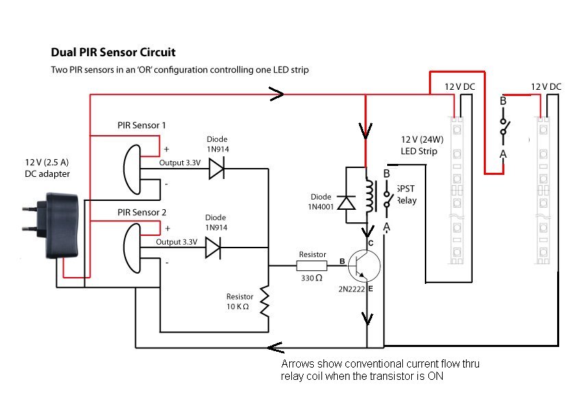

The relay coil needs current flowing thru the coil to operate.

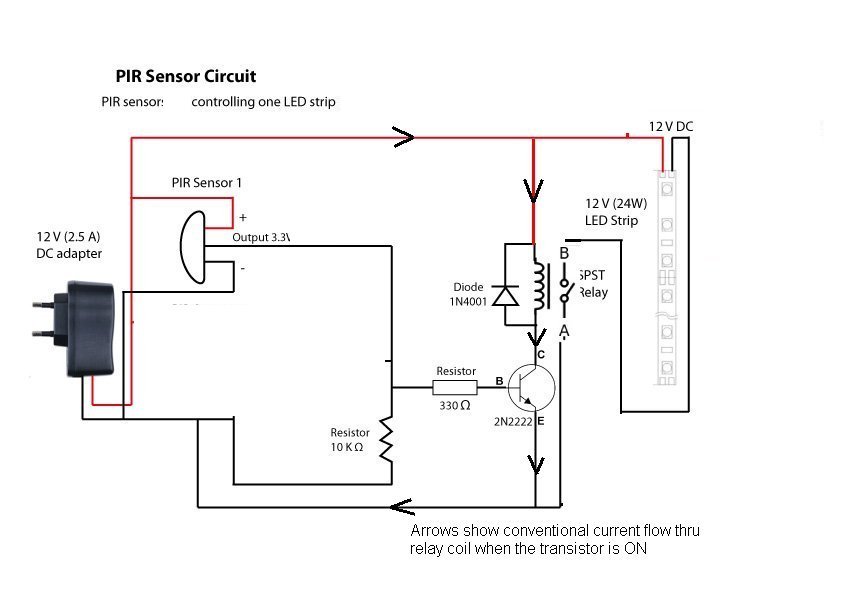

hi Roger,
Try this circuit, its for one PIR.
NOTE:
Set the 's' for sensitivity and 't' for the ON time of the PIR [ marked pots mounted on the PIR PCB]
Allow about 2 minutes settling time for the PIR after powering up.

Sorry, Ian. I know hijacking is not good. Wont happen anymore.
Thank you Eric.
How many watts should resistors be?
R.
Thank you Eric.
R.
I would use 0.25W [ or higher if that's what you have]

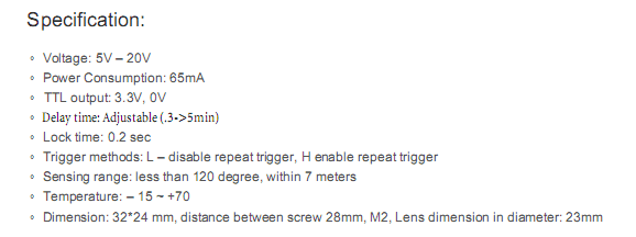

Hello.
I noticed that when HC-SR501 goes off, it has a delay to turn on again after 6-7 seconds. (wawing infront of the sensor)
Is it possible to modify HC-SR501 to switch on immediately when motion is detected (after it goes off at timer)
hi R,
That dead time after an active ON period is called the blockade time, which appears to be fixed.?
Would repeat triggering of the PIR be acceptable for your application.?
In other words the PIR output is High/On while movement is being detected.?
E
Hi, Eric.
I guess so.. it is ment to be for led lights in the bathroom. My wife always forget to switch off the lights :)
I would like to set the blockade time to minimum.
I tried rotating trimmers, but couldn't get it.
Thank you,
R.
hi Roger,
The blockade' time as the spec describes it, is fixed.
Thanks for the video showing that modification for the 'blockade' time.
Pleased to hear its working.
E

You could add a second sensor by using the original dual PIR circuit, posted earlier.
Modify the 'blockage' time on the second sensor to suit the app.
E

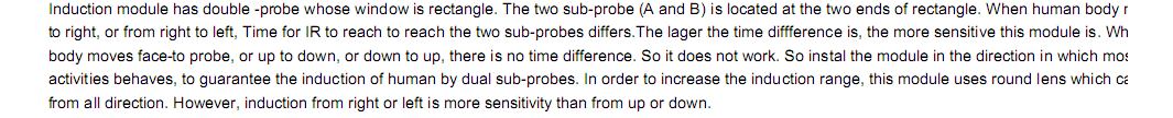

EDIT:
Note the direction sensitivity.
Hello Eric.
Thank you for clarification of direction sensor sensitivity.
If I want to use 5V input (for other project), what do I need to change in the circuit?
I already have 5V relay.
Edit:
Actually I connected as it is and it is working, but just want to be sure.
R.
hi Roger,
That PIR unit will work with a Vsupply of 5v thru 20v.
It has an board 3.3v regulator, so the output swing is always 0v to +3v
E
