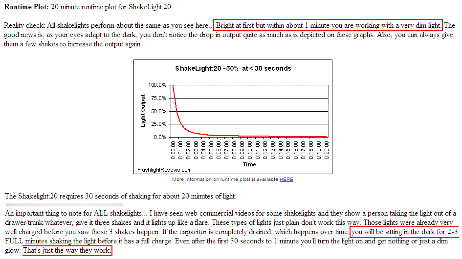

A review of the expensive shake-light made by guess who says it is not good:

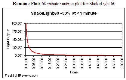

Here is what I'm talking about.
ShakeLight:60 battery-free LED flashlight magnet powered shake light
you use capacitors, not batteries, to store the charge. The capacitors have a slow drain rate because the load is almost nothing, and thus you can light the LED for quite a while before you need to recharge it.
The same review that I posted for the ShakeLight 20 tested the ShakeLight 60.
They are almost the same. The capacitor discharges quickly. After less than 1 minute the light was half. In 5 minutes the light was about 8% and dim. In 30 minutes the light was very dim and in 60 minutes the light was almost zero.
