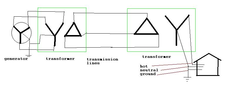

shown is a quick crude drawing of what happens between the generator and your house. the thick lines are windings. the thin lines are wires.

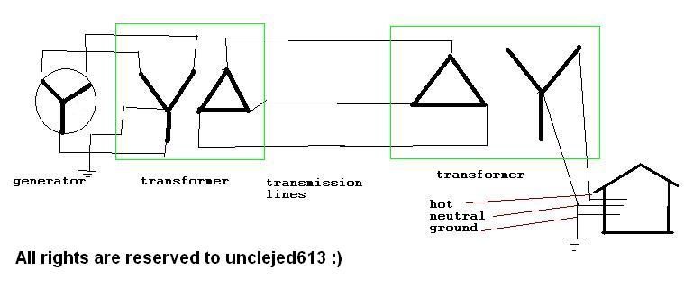

sorry, pic didnt upload.... lets try again
Are you trying to show on your picture that the generator at the power station has a Neutral point connected to the star point of the transformer?
Sorry, I don’t agree with you. A motor can act as a generator. Do you connect neutral to a 3 phase motor? No. The same for the generator at the generation end. It does not have the neutral point. Neutral is only tapped out at the far end (domestic use for example) where a group of houses are connected as you indicate on your picture.

SPDCHK, So what connects the generator at the electricity company to the ground?
It must have a reference point to ground, mustn't it?
You meant that its suppose to be like that?
actransmission-jpg.29730
Well in the U.S the last transformer would be drawn a single phase, (split phase with center tap, 3 wires) output with two hots and one neutral. Potential between the two hots is nominally 220vac and potential from either hot to neutral is 120vac. Showing a Y output transformer winding is not correct for the common house U.S. installation.
Lefty
as i said, it's a crude drawing...... the generator could even be delta wired too (Tesla'a patent has it wired wye), but the distribution point and the transmission system was basically what i was getting at. the secondary of the distribution point doen't necessarily have to be a wye with a ground either, as each of the 3 windings could feed the primary of a split-single phase transformer, where the secondary of the split phase has a center tap which is the neutral for two 120V sections which are 180 degrees out of phase, giving 120V for each half, and 240V total between the hots. this is the standard house service.
3 phase service (for large offices and light to heavy industrial) takes the points of the wye (or star) as the 3 phases, and the center tap as neutral. there's 120V between each phase and neutral, and 208V between phases. the neutral is grounded at one place, at the "service entrance", there are special applications that use 3 phase delta transmission directly to the end user, one of which is the motors for driving pumps for sprinkler systems in high rise buildings (obviously this isn't at the normal voltages in the tens and hundreds of thousands of volts, but at the 480V that is used for the motors).
It's normally connected to earth to prevent it floating at high voltages. Without an earth connection the 230V supply could float at any voltage, if someone connected a 10kV autotransformer to it and the secondary got shorted to earth, the mains would float at 10kV which would destroy the insulation and cause a fire.
Bonding ensures that the highest voltage relative to earth is the phase voltage.
The secondary of the distribution transformer could even be delta wound, a neutral point could be formed by a zigzag transformer placed nearer to where the load is. Delta is better than star for low voltages and high currents and zigzag transformer are good for harmonic reduction as well as creating a neutral point.
