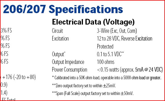

Hi Paul,
From the data sheet i viewed it is only a 3 wire sensor V+, com, output, so V+ would go to 24 volt+, common would go to Negative, and output to the picaxe input.
Data sheet here....... **broken link removed**
Pete.
