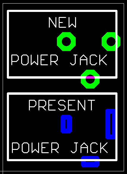

Hi All,
haven't you wondered about the bulky designed DC-power jacks you'll have to use making a small board and use your lab power supply for it?
I'm in close contact with Cherng Weei (Taipei, Taiwan), a PCB-connector manufacturer and have suggested to alter the design fitting easily onto a PCB.
The original connector uses metal strips of 2.8 respectively 2.1mm length and 0.3mm thickness, not easy to make a solderable footprint on a PCB.
The new design uses pins instead of strips and can be inserted using through-holes.
To take care of sufficient current flow the pin diameter will be 1.2mm, using any pad size according to individual requirements.
I've already suggested to send me a bunch of at least 50 free samples, which of course are intended for the forum members for testing.
The only favour I'm asking for is showing one sample (two each member) to your local electronics dealer or distributor to have them order the stuff at Cherng Weei.
Regards
Hans

He is not talking about SMT version. Rather a thru hole conn with round contacts as oppossed to slots which are more expensive to cut into a pwb. I personally might just go with SMT, but thru hole does have the advantage of mechanical strength.

Your thumbnail has one flaw. It is possible to connect the plug incorrectly, with catastrophic results, unless the plug and socket are molded to fit only one way. The thinnest connectors I use are on my cellphone. SMT connectors have limited electrical current capacity.
The jack can only be used one way - with the plug receptacle pointing away from the board. Since it has three pins - additionally with different strip widths it can only fit in one direction. You might obtain catastrophic results not connecting the plug the proper way.
These connectors (plugs) are normally attached to wallwarts and it is up to the user to select the appropriate polarity.
