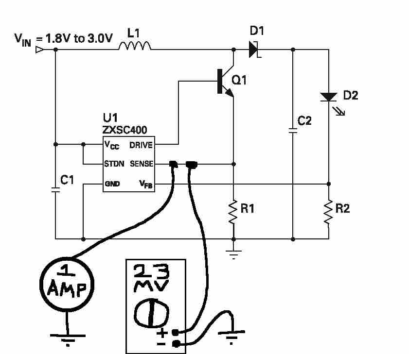

Yup, you heard right, I want to use the zxsc400 instead of the zxsc100. The main reason is that the current output only drops by .01amps when the battery goes from 3.3V to 1.8V! Can't say that for the zxsc100.
The other reason is that the component count is smaller and I was able to get all SMT parts for this circuit.
I'm having one problem with it though. It is the current sense resistor, R1, which is a 17milliohm resistor. This is what the datsheet says:
R1 is small and it is strongly advised to take track resistance into account. A proven method is to source a 1A current from the sense pin to the ground pin and check for 16-17mV. This resistor can be made from a 15 milliohm resistor with the track resistance contributing the difference.
I did exactly what it said and measured at the current sense pin. Problem is, I got 23mV, which means that my track resistance is too high.
I'm just wondering if I'm doing everything right? I have everything connected exactly as in the diagram. Ground is a piece wire sticking out from my board.
Also, how do I improve the conductivity? I have a layer of solder over the entire part of the circuit that is conducting the 1 amp.

Hi everyone again. I really need some help on this and I'm sure someone knows the math.
I have a 15 milliohm resistor and I need the track resistance to make up 2 milliohm to make 17 milliohms. If someone could give me the track area that I need in order to make this I would be greatful. Here is the info on the type of board that I have:
The copper on 1 ounce boards is 1.34mil thick (0.0341mm). This board is made of FR4 which is a flame retardant version of G-10 material. This flame retardant laminate is translucent in color and made of continuous woven glass cloth impregnated with epoxy resin.
Developed specifically for the circuit processing industries' requirements. Complies with Mil-S-13949H-GFK. Provides ultraviolet blocking and fluorescence when using automated optical inspection (AOI). UL# E37002A; 4/5/91
Provides high resolution and excellent fine line control. Ideal for prototypes, small production runs, and student training.
I get L/W = 3.948.
This comes from R=r*L/A where r=Cu resistivity=.6788e-6 ohms-inch, R=resistance (.002 ohms in this case), L=trace length, and A=trace cross-sectional area=W*t, where W is trace width and t is trace thickness (1.34 mils in this case).
**broken link removed** says the width should be at least 10 mils for 10 deg. C temperature rise. I think I would at least double that - maybe quadruple.

L/W=length divided by width. If you keep that ratio constant, you will get 2 milliohms (I hope), independent of the actual values. Since you will probably choose W to handle the current (I suggested 40 mils), then Length=3.948*40 mils =160 mils. If you make W=0.1 inch (100 mils), then L would be 0.4 inch.
1 mil=1/1000 inch.

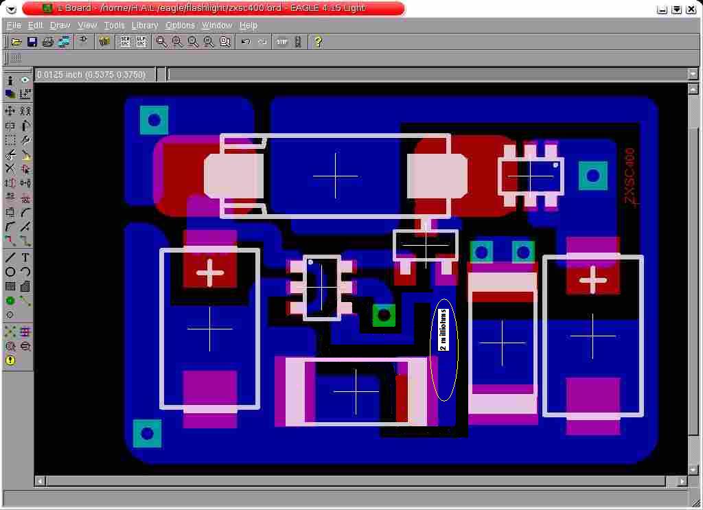

Well that's a fly in the ointment. I don't have room for a 100 mil wide 400 mil long trace. Take a look at my layout. What's circled in yellow is the track that I need to be 2 milliohms. Maybe I'll just bite the bullet and hope it works with what I've got. I'll have to put some solder over it as well.
My last board didn't work because come to find out I had the transistor connected wrong. DUH!
I also might have the capacitors connected wrong. I assumed that the end with the stripe across it is negative polarity just like in through-hole capacitors. This whole board is SMT.

You need to keep in mind that the current flows through the emitter of Q1 and through R1. It doesn't flow through the trace you circled.
Also, I didn't say it had to be 100 mils wide. Reread my post. 40 mils should be more than adequate. I reworked your layout to show you where the 2 milliohms needs to be.

From my first post:
This chart says the width should be at least 10 mils for 10 deg. C temperature rise. I think I would at least double that - maybe quadruple.
Note that 10 mils, quadrupled, is 40 mils (see next quote).
From my second post:
Also from my second post:
So yes, I said that, but it was just an example. What I was trying to emphasize is that the resistance will be 2 milliohms if you make the length 4 times the width. You can choose any width that will not burn up with one amp flowing through it.
And I had a heck of a time removing that danged yellow "circle" from your layout. :(
Ron, I've figured out the equation with these values for W and L:
W-.04
L-.16
I got R=.0124
Am I doing the equation right?
I don't get how you got the 1-4 ratio of width to length though?
I'm doin' my best here, please bare with me. It took me 20 minutes to try and get the equation right :lol:
Let's see if I can get the same answer twice. :roll:
R=r*L/A, and keeping in mind that A is cross-sectional area (not surface area),
A=W*t
so
R=r*L/(W*t)
solving for (L/W),
(L/W)=t*R/r
t=1.34*10^-3 for 1 oz copper,
r=0.6788*10^-6, resistivity of copper
R=2*10^-3 (2 milliohms)
so
(L/W)=1.34*10^-3*2*10^-3/0.6788*10^-6
(L/W)=3.948 I rounded it up to 4
Checking,
R=(L/W)*r/t
R=4*0.6788*10^-6/1.34*10^-3
R=2.026*10^-3
which is darn close to 2 milliohms.

Ron, thank you for your patience, I finally got the right answer. Part of the reason is that I've never really understood how to work with a scientific calculator and the: xxxxe-x. I stumbled through it, entered my track length and width and in the spirit of trial and error finally got the right sizes.
Can't say I understand the L/W equation, but I'll do that another time.
