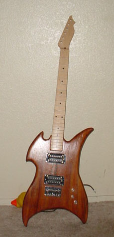

It depends on the pickup. High powered do reach a volt at the expense of sound quality. Pickup flavors are offered in low, med and high output. Head bangers most likely go for the latter. My first home made guitar used med power humbuckers as I like the noise cancelling that humbuckers provide.
It is a matter of opinion I suppose.
