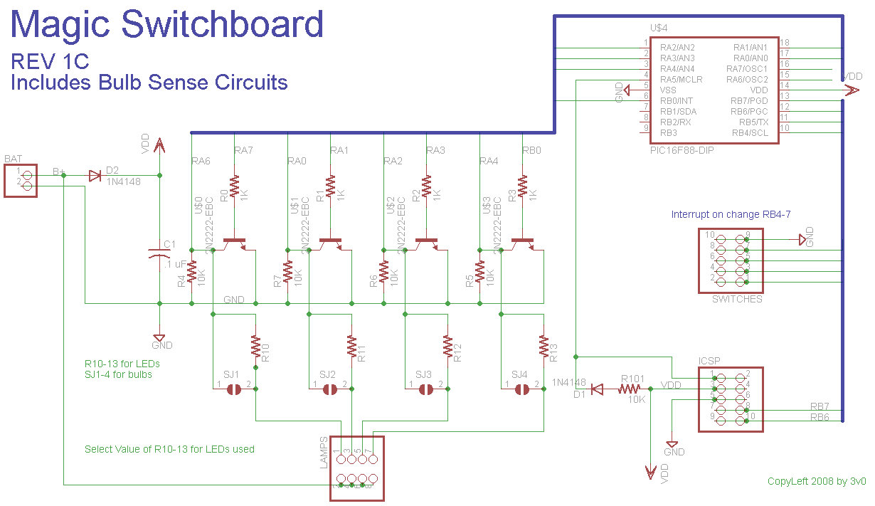

Just going through this eagle program's tutorial. Obviously I'm new at this, but when they refer to a bus this meant as a means between two seperate objects, either though a ribbon, cable or such. Am I correct?

Peter is correct regarding meaning of bus. It is just a way to clean up a schematic.
Suppose you ran signals A-Z from one place to another on the schematic with a bus. When you layout the board it will be no different then if you had used a individual net/wire/line for each signal. A net that goes into a bus anywhere can exit the bus anywhere.
The wide blue lines in the attached schematic are buses. Notice how the top bus picks up all the signals related to the transistors. The bus on the bottom right has the signals for the switches and ICSP connector.
EDIT: If you give two physical nets the same name they will be connected whey you layout the board. In this schematic I got sloppy and did not cause RA6 and RA7 to join the intended bus at the processor. But they are shown as part of the bus in the area of the transistors. This still works because I have given each section of the net(s) the correct name.
You use this same feature used a lot for power and gnd. It would be messy to run these all over the schematic. Instead we show what they are with a label (ABC) after giving them the correct name.

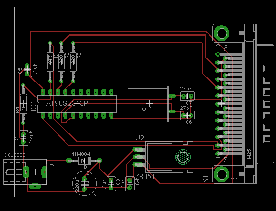

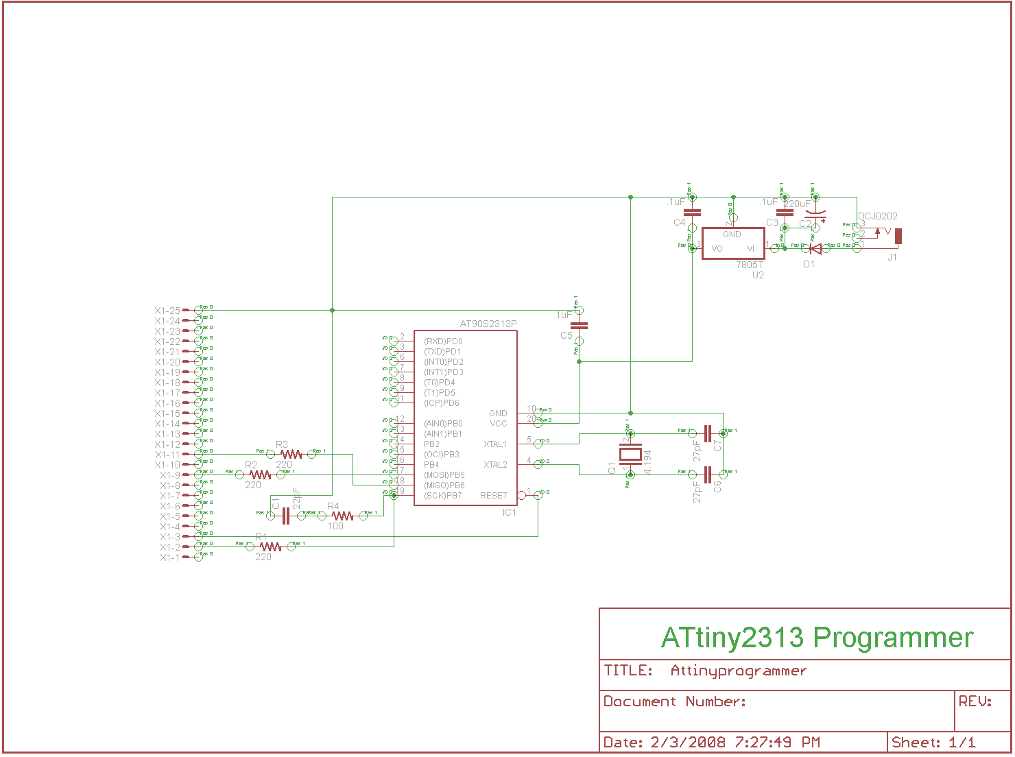

Thanks for all your help. I did do a quick draw up of a AVR Programmer I want to build. didn't change any of the settings yet. I will go through with you instructions. Attached is a copy of my schematic and the board layout.
As for laminator. I have a lamanator we use for documents and such. is this the same as one you use for PCB's?
Just looked at you board. Unless you changed it red is used for the top side layer. Your traces should be on the bottom layer which would make them green like the pads.
Keep in mind that you do not have plated through holes so you need a via with a wire in it each time you change layers. You can not do it at a IC socket pin. You can do it at a resistor if you solder it top and bottom.
If you don't tell the printer, it won't know. Just make sure it isn't a mirror image thats printed.
BTW, my bottom layer comes out blue.:confused:
Correct, top red, bottom blue, pads green. Mind fart
You are right about the printing but he may as well get it right to start with.
:rolleyes:
Thanks both of you. I was thinking when I did it that copper will be on bottom.
but didn't apply it what I was doing "oops".
As for the via's ext. in this board I don't need to wory about them here do I, as all components will be soldered to copper on the bottom. Right?
I was just working the schematic for project #2 which will be a double sided board, I was going to use the Resistors as VIA's as you said this is good right?
Yes, your board has one layers and no jumpers.
Yes. If only a few resistors are used as vias I document which ones and add that info to a text file kept in the project directory. You can also look at the top side of the board and solder all resistors that have traces leading to them.
From the control panel you can do an edit description. This is at the project level. I use that to document what the major changes are for each rev of project.
With your existing board, you can correct it by,
Use the group tool and draw a box around all the board.
Use the change tool and select layer 16-bottom.
Right click on any trace to change them all.
