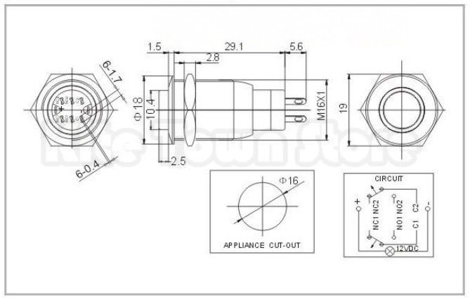

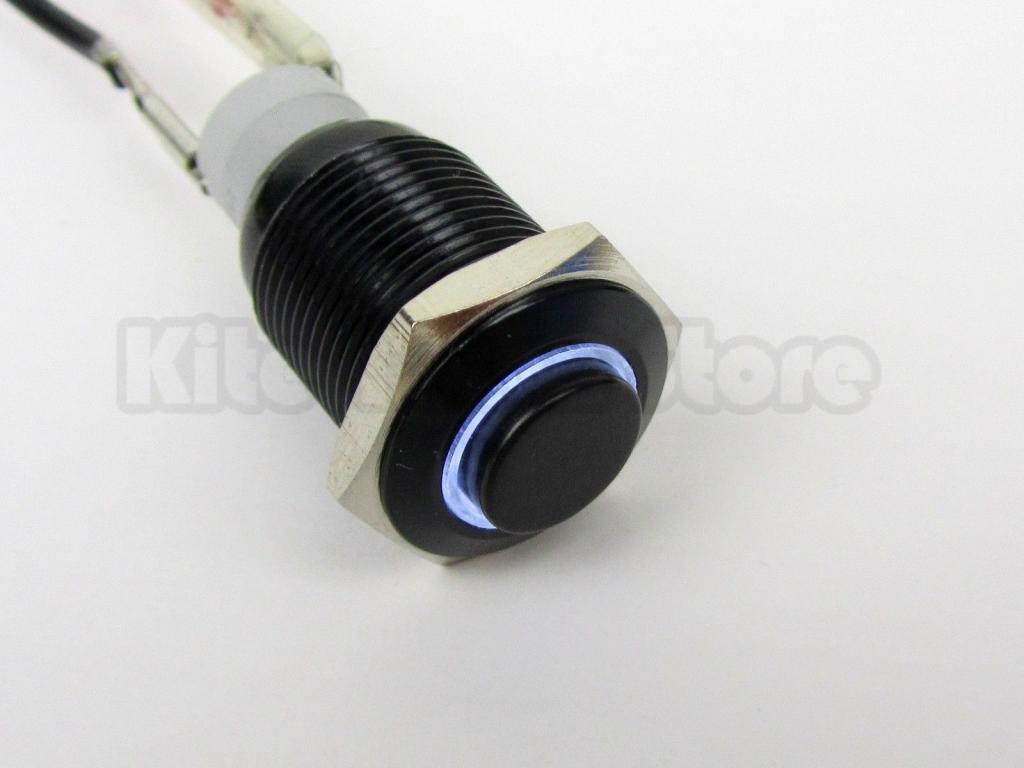

I want to completely remove the key ignition system on my 1992 Honda Accord Wagon. Instead, I want to have (in this order from left to right): Latching switch, latching switch, momentary switch, latching switch. The first two will be white led halo latching switches, the third will be a red led momentary and the last will be a red led power symbol latching. The first is for the IGN (ignition) position of the key. The second is for the ON position of the key. The third is a momentary that will continue to start the car as it is depressed. The last is essentially a kill switch or all power on/all power off. To further complicate things, I want the three latching buttons' leds to come on and they are depressed, however I want the momentary one to be the inverse of that. I want it to turn off while depressed, but on when not pressed.
Here are a few images that may help with understanding exactly what buttons I plan on using:

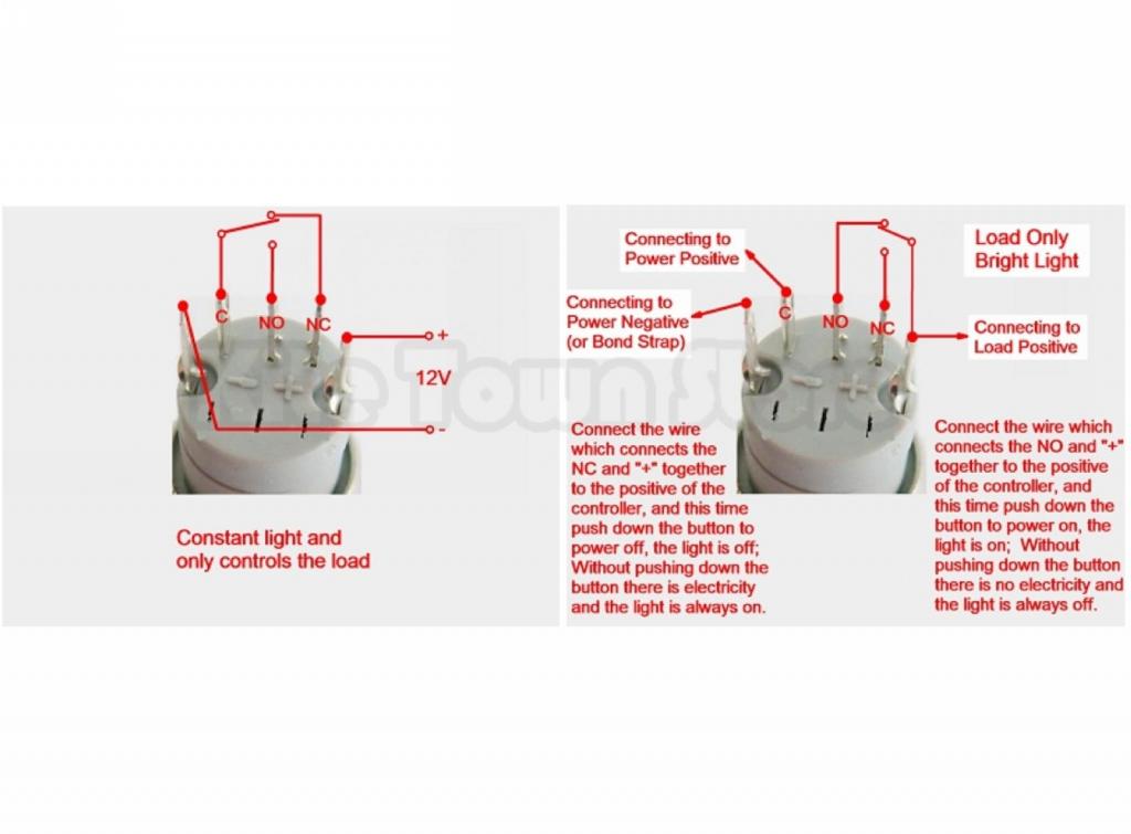

Ok, so I need to verify this but when using a momentary push-to-start (being the third button, it needs to be on when it is not being pressed and off when depressed. Granted, I do not want to have to depress the button the entire time I drive, lol, so is there some way to reverse the switch's behavoir? HOWEVER, I do believe that the switches I am buying have the option to either be open when on or closed when on. Secondly, I understand the basics of the ignition in a car, but explain to me this, if you can... Does turning the key from IGN to ON turn off the IGN and turn the ON on? Or does the IGN turn on and stay on when it is moved to the ON? If it does the first of the two, I would need to make it so that when I turn the ON button on, it would override the IGN button's circuit.

Latching switch

I would wounder if the current rating on the switches used was enough.
The hole thing was really bad.
The switch's you want to use will never carry the current needed. Thats why you need relays.

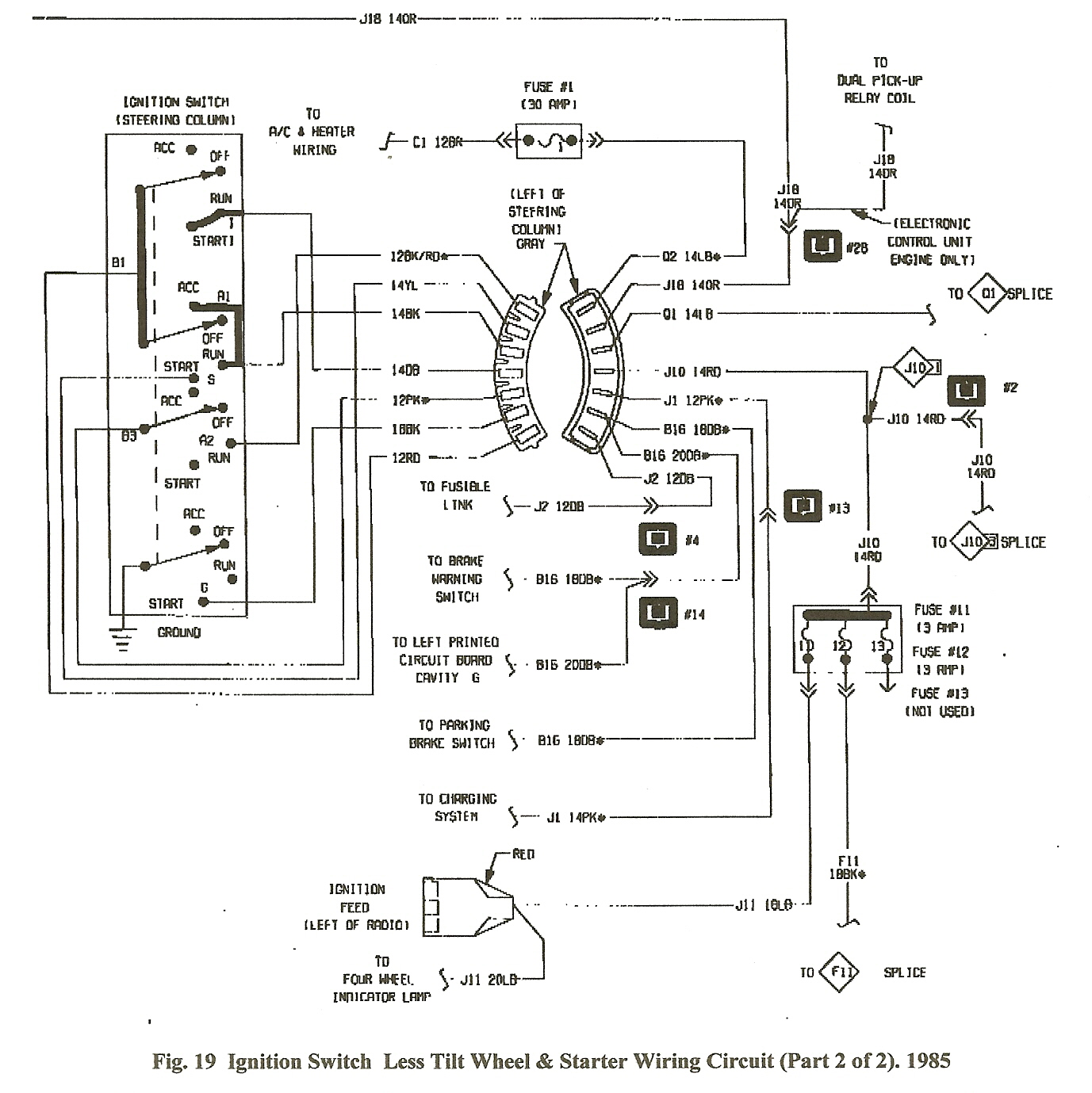

Usually in a car wiring schematic, the ignition switch inner circuit is shown, at the switch. Then you trace from there to the rest of the circuit.
Can you explain the IGN1 and IGN2?
If you follow the wiring from the key switch on your diagram you should see that IGN1 is everything the engine needs to run and ING2 is everything else that goes on and off with the key.IE Lights, heaters and windows. ING2 is disconnected when the car is cranked over.
can you elaborate as to how the relays will allow me to use those switches
Your switches can only handle low power 1 or 2 amps without burning up.
The circuits you are trying to switch are high power like 20 to 60 amps.
So you use your switch to power the relay that controls the high power circuits.
