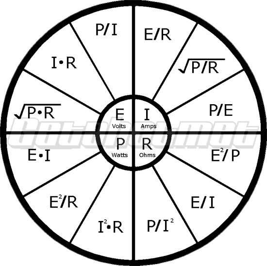

Ohms law
It's a little more complicated than that but not much. Here is a chart that will make you an expert. :=)
Lets use the example of the LEDs. The 4066 IC has a resistance of about 180 ohms, when on, plus the 330 ohm resistor so 510 ohms total. The LED has a little voltage drop across it when its on (lets say 2.5 volts). That leaves us with 3.5 volts divided by 510 ohms or .0068 amps (6.8 ma). Total power I X E = .041 watts (not much) So when we changed it to 12 volts the IC resistance and the LED voltage drop stay the same and we end up with 9.5 volts / 860 ohms or 11 ma. and the power goes up to .13 watts. Still pretty small. So to make it just right (or the same as before) you would want the total resistance to be 9.5 / .0068 or 1397 ohms. Subtract the IC resistance and you get a resistor of 1217 ohms or 1.2k ohms. If I hadn't been lazy this is the value I would have given you. Quiz: What is the power with the 1200 ohm resistor?
