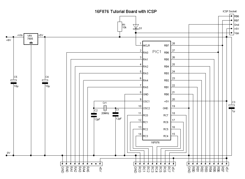

Anyways, a few threads back Nigel Goodwin posted a schematic for ICSP connectivity. Reading the PICKit2 user guide i see there is no mention of extra wiring between ICSP and ICD. Therefore i assume that with the same schematic i will be able to download and debug code via PICkit2 and MPLAB.
As my first project i want to build a simple LED light flasher thingie with a regulated power supply.
The pinout of the PICkit 2 is as follows:
1. VPP - Goes to MCLR pin of target PIC
2. 5V/3.3V - Can power your target board if it doesn't draw too much current
3. Ground - Connect to target ground
4. PGD - To PGD pin of PIC
5. PGC - To PGC pin of PIC
6. NC (Not Connected)

Pin 1 - VPP - To the MCLR pin on the chip. Don't forget to put a 33K or so pullup resistor on MCLR too (not critical - anything from 10K to 33K is ok).
Pin 2 - 5V - To VDD on your target circuit.
Pin 3 - Ground - To Ground on your target circuit
Pin 4 - PGD - To the PGD pin on the PIC
Pin 5 - PGC - To the PGC pin on the PIC

I see that the 28 pin board has 2 6 pin connectors. Will one accomodate a PICKit as an ICD? Are there any schematics for these boards?

Schematics for the 28 pin board can be found here:
https://www.electro-tech-online.com/custompdfs/2009/01/41301A.pdf
One 6 pin connector is for ICSP with PICkit2/ICD2 etc. and the other purely for PKSA. If the target supports debugging (supported 28 pin devices listed in section 1.3) there shouldn't be any problems, provided you remember to use the debugger option in MPLAB, then remember to reprogram with the programmer option afterwards. :eek:

... Do you mean i will always have to switch between debug/program modes to use the PICKit? I don't recall this with the ICD2.
The PICkit works the same as the ICD2 in that regard. You select debugger or programmer from the MPLAB menu. The debug mode can program so there is no reason to switch back and forth.​

You're both familiar with debugging so this is preaching to the choir, however for others following this thread, a little clarification is needed.
During a debugging operation, the device is programmed using the debugger menu in MPLAB IDE. This option loads the debug executive code into the device in addition to the application code, to allow debugging to take place.
Once the application is debugged the device needs to be reprogrammed, using the programmer option, to remove the debug executive code and return the device to stand-alone operation.
