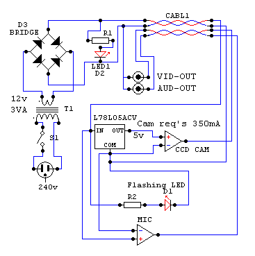

Hi, Firstly what a great site – haven’t found anything on the net as good! – Secondly PLEASE HELP – I have put together a circuit that I believed would work I have 2 main problems 1: interference 2
roblems with voltage oh and thirdly I know only a very little about electronics but i am getting there! I have included a circuit diagram of what I have produced. I am getting interference from my flashing LED’s & lots of noise on the mic line (like a constant buzzing drone) I believe I need to add capacitors but I have no idea where or how they work / effect the circuit. Secondly my regulators don’t seem to power the CCD cameras, from what I can tell they are supplying 5v but I don’t know how to check this properly? I know the circuit dig has a few odd components but there representations as close as I could find in my prog. If anyone can provide any suggestions I would be very grateful.
