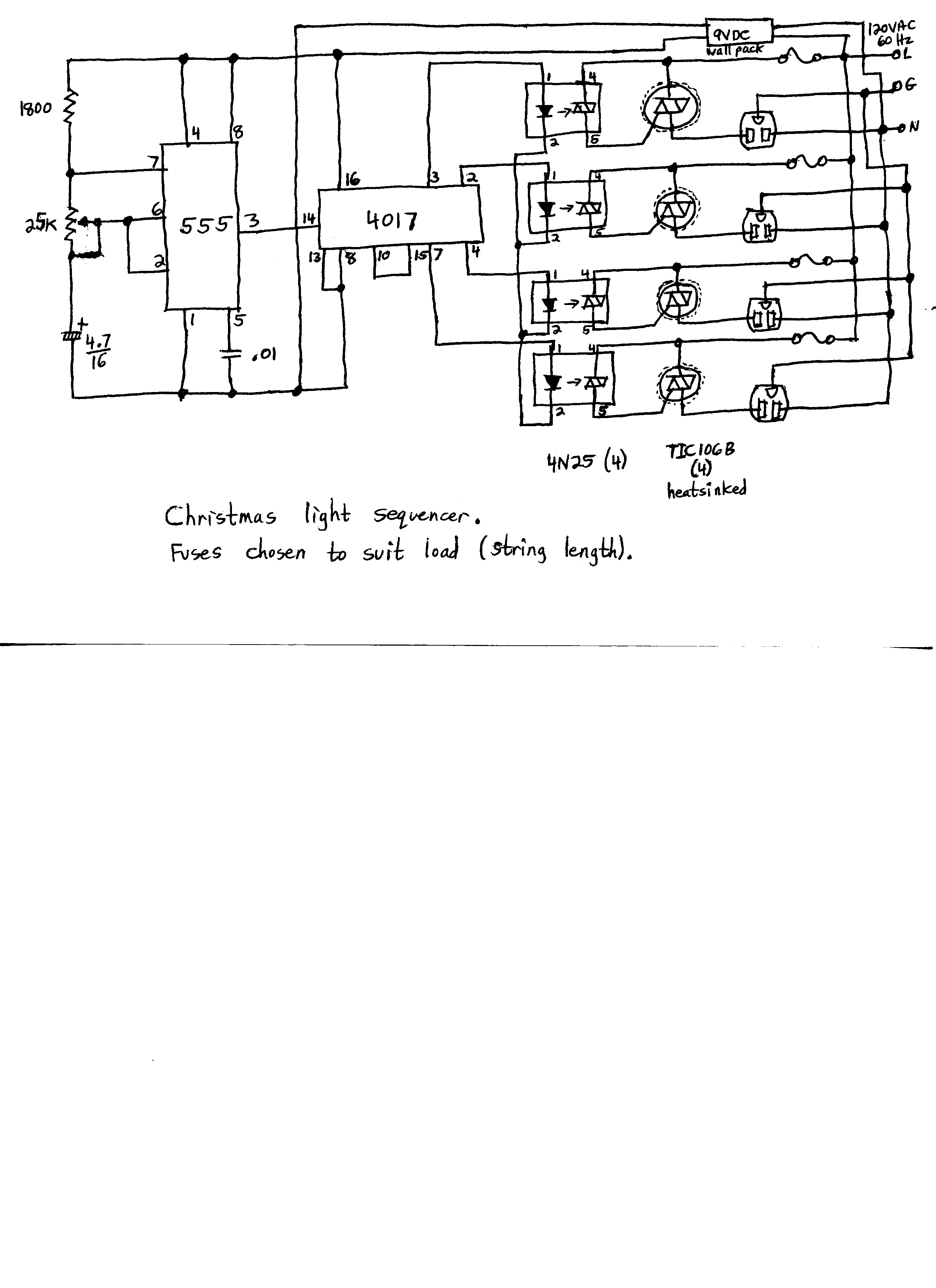

I can supply you with a simple circuit that was built 20 years ago, and continues to delight passersby. Originally for Christmas lights, it can be adapted for your needs.

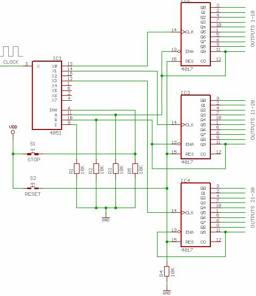

Hi Ian,
I thought about cascading decimal counters of the type CD4017 and came to the conclusion that it can't be done just by wiring an output of one to the clock input of the follow on stage. That way the second counter would only advance by one if the preceeding has counted through 10, meaning the second stage would be clocked at 1/10 of the original frequency.
To overcome this problem an analog multiplexer can be used. I made up a small sample circuit showing the idea.
Inputs A,B, and C are binary coded inputs switching the common input to one of the outputs X0 through X7. All inputs low means X0 is active, input A = H means output X1 is active. To activate X7 all three inputs A,B and C have to be high.
The sample circuit does not include a logic coder to activate any desired output. If A and B inputs are high output X3 will be active. To have output X2 activated, input A requires turn off which can be accomplished by a coder circuit.
Anyway, the complete circuit lets you count from zero to 79 at the same time intervals.
Hans

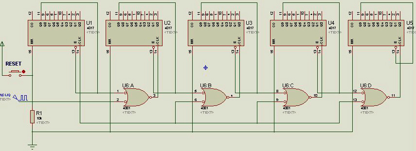

Hi Ian,
cascading CD4017 is much simpler using AND-gates. That way you might have hundreds of sequenced outputs.
For manual clocking use a debounced key and for automatic clocking use an NE555 timer circuit with variable frequency output.
This is how cascading works.
Hans
