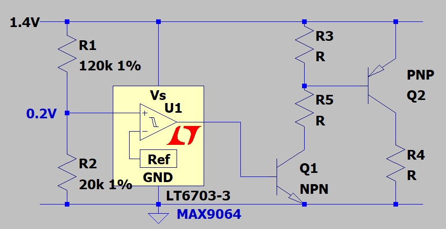

Hi Guys - your help here is highly appreciated !
I have 20 x NiCad (flooded cells) of 1,2v 32Ah each, wired in series into a 24v bank. Float voltages per cell is 1.40 - 1.42 V/cell.
(I actually have 80 cells connected in 4 x 20 cells each iaw for a total of 128 Ah - charged with a 24v 3KWh Invertor )
Have looked at off the shelf BMS's but is above my pay grade - (most are designed for other batteries types and I really only need balancing)
I had a look at the attached circuit found it on YT. Can this circuit be modified to balance 1.4v cells even if I need to build 1 each for every cell.
I am aware that the cell voltage of 1.4v is low for most components to function on - which means that 24v from the bank will be needed to power the circuit
1. will need to use the bank voltages of 24 vdc via n ± LM7805 or something similar circuit to drive the BMS's for each of the cells.
2. Then a censing circuit to read the cell voltage 1.40 v adjustable (preferably multiturn pot) and use this to activate the BMS in 1. to balance each cell via a load resistor.
3. I think both circuits need to be isolated from each other by an OPTO or something.
Any ideas please share - A simple but effective circuit that I can build to balance each cell would be appreciated.
My electronics knowledge is quite limited component wise - I can build and test n circuit thanks to YT and other platforms that I have learned from ect.. But the intricacy's of component values etc. not well versed.
Thank you for your interest and help in this project

I can't find it now but I saw your circuit from china for very little money. Adjustable over a voltage range. Search alibaba.com or amazon for battery balancer.
Your circuit has a TL431 inside. It can not work below 2.5V or maybe 3V. There are other versions of the part that should work to 1.25V. If you need the circuit modified one of us could take a look at it more.

Hi Ron
I noticed that most BMS dont work that low a voltage, I would really appreciate if it can be looked at. If one can power the main circuit from the 24v supply side and the sensor side from the 1.4v from the cel tie self can this be n workable !
What version of the TL431 can go that low? or is there maybe a nother work arround ?

that balancer looks nice but min voltage is 1.8v
your circuit. The TL432 looks at the spot where I wrote 2.5V. If the voltage is less than 2.5V it pulls very little power and the transistor is off. If the voltage is more than 2.5V it pulls power turning on the transistor and putting power into R6 and the LED. R1, R3&R4 divide down the battery voltage.
There are several voltage references much like the TL431 but with a lower input level. TL4051 is an example set at 1.224V.
I need to think about this a little. The TL4051 acts strange when the battery gets below 1.6V.
NiCd cells, including wet types, are self-balancing - just trickle charge them at 1/20C or less and they will charge fine & not be harmed.
As long as they are then allowed a low level trickle charge for some time after each discharge and normal charge cycle, they will stay balanced.
The charge voltage should be 1.55V per cell, set for the overall battery. Once that voltage is reached at full current charging, reduce to 1/10C then when it's reached again reduce to a low trickle charge, 1/20C max, down to 1/50C even.
There are a number of voltage Comparators with built in voltage reference. Do not use the LT6703 or most, because then do not work below 1.4V. Use the MAX9064 because it works at 0.8V to 5.5V. Internally there is a 0.2V ref voltage. When the "+" input gets above 0.2V, Q1 & Q2 turn on and dump power into R4. I need to know what the charging current is to design the rest of the circuit. I did not put a LED in the circuit because there is no LED that I can find that will light near 1.4V. (IR LED work but I can not see them, lol)
Good luck Ron Simpson
