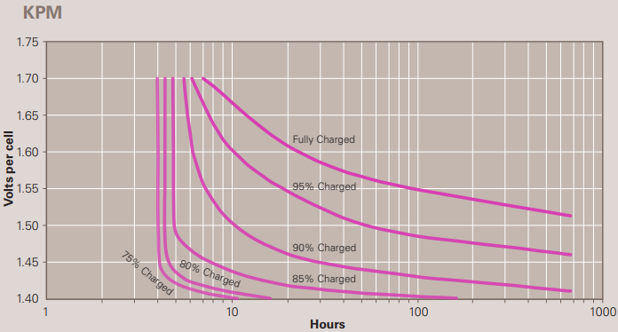

for those that don't want to dig through the datasheet.

This show the cell volts from 1.7v per cell, which is the equalizing voltage per cell. I don't really understand this chart. As I see it you will never get these cells to full capacity? especially if they are charged at for example 1.45v ?
Why is it not necessary to balance the cells?
NiCd (and many other rechargeables) "leak" a small amount of current, especially when at or near full charge, so all cells in a battery pack chain get a steady trickle charge which automatically equalises them.
Lithium battery types are an exception, as they have near zero leakage so no self-equalisation.
It looks like those particular cells have a higher full charge voltage than the ones I found data on at the start of this thread, so the approx. 1.66V per cell is fine, and they have already balanced to +/-20mV of their average voltage.
