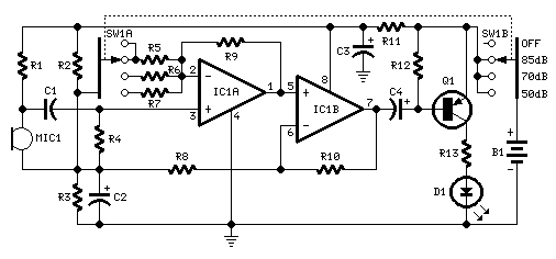

Hi Friends,I am Building a Room Noise Detector....
But I am Facing some problems with it, can anyone please suggest the corrections that should be done to work circuit properly????
The list of components and ckt diagram is here....

Device purpose:
This circuit is intended to signal through a flashing LED, the exceeding of a fixed threshold in room noise, chosen from three fixed levels, namely 50, 70 & 85 dB. Two Op-amps provide the necessary circuit gain for sounds picked-up by a miniature electret microphone to drive a LED. With SW1 in the first position the circuit is off. Second, third and fourth positions power the circuit and set the input sensitivity threshold to 85, 70 & 50 dB respectively.
Current drawing is <1mA with LED off and 12-15mA when the LED is steady on.
Use:
Place the small box containing the circuit in the room you intend to measure ambient noise.
The 50 dB setting is provided to monitor the noise in the bedroom at night. If the LED is steady on, or flashes bright often, then your bedroom is inadequate and too noisy for sleep.
The 70 dB setting is for living-rooms. If this level is often exceeded during the day, your apartment is rather uncomfortable.
If noise level is constantly over 85 dB, 8 hours a day, then you live in a dangerous environment. NoiseDet.gif
Yes, it's difficult to know what your "problem" is without you telling us. There are very few psychics in this forum.

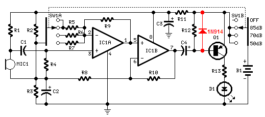

The transistor should have a diode from base (anode) to collector(cathode) so that C4 can discharge.
C4 is quickly charged by the base-emitter diode of the transistor which is about 20 ohms. Then it is only partially discharged very slowly by R4 which is 100k ohms. So C4 keeps charging and charging until the transistor does not work anymore.
The added diode discharges C4 on each half-cycle.

When there is loud sound then C4 charges through the base-emitter diode of the transistor which turns on the transistor and the led.
But C4 cannot discharge quick enough into R12 so C4 charges to a higher and higher voltage on each half-cycle of the sound until the transistor does not conduct anymore.
Adding a reversed diode across the base-emitter of the transistor will discharge C4 on each cycle of sound, or changing the circuit so that it is DC-coupled.

The LM358 has inputs that work at its negative power supply voltage that is ground in this circuit. It can rectify the input signal and directly drive an LED without the inaccuracy of the base-emitter voltage of a transistor. Then the coupling capacitor in the original circuit is not needed.

IC1A is a very simple opamp non-inverting amplifier. Its gain is 1+ (R9/R switched). it is biased at half the supply voltage by R2 and R3.
IC1B is another simple opamp non-inverting amplifier. Its gain is 1+ (R10/R8).
It is biased by the output DC voltage of IC1A.
C2 filters the half the supply voltage bias voltage. R4 is the input resistance of the IC1A amplifier.

hi friends iam building a room noise detector circuit the circuit does not working properly please tell me the modifications to it i have seen that it is missing a diode what is the diode number and specification where it should be placed
My corrected schematic shows a 1N914 diode but a 1N4148 is the same.
