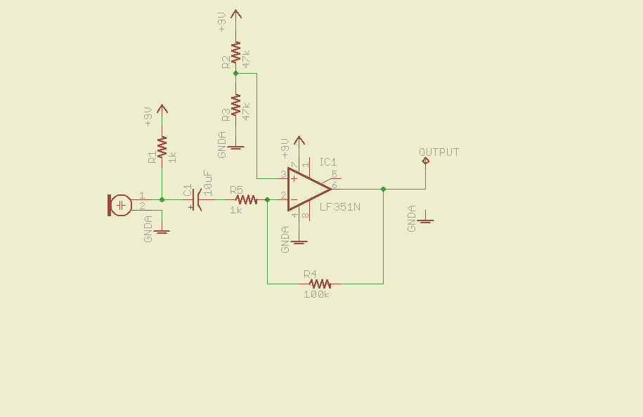

I just made a preamp for myself .. based on a LF351 I had lying around.
I did not AC couple the output from the amp however.
I get a constant noise at the background (like an Airconditioner heard from inside the room). We have central heating and I am sure the noise upstairs does not come down so much for the mic to pick up.
Is it because of me not ac coupling the output?

The old LF351 opamp is not a low noise audio opamp. Of course it will produce hissss.
The output coupling capacitor has no effect at high hiss frequencies, its value affects the circuit's lowest bass frequency.

The LF351/356 J-FET op amps are very good amps for LINE LEVEL audio applications where 0 dB signal levels are pretty high. For microphone or phono pre-amps, they are not good enough. The best amp used to be the Signetics 5532 type, don't know if they are still the best, but they are very good.

Maybe the circuit is 'hooting' @ few 100 kHz? (due to bad layout maybe)
I think it's more likely to be a ground loop problem or the lack of shielded audio cable than the op-amp.

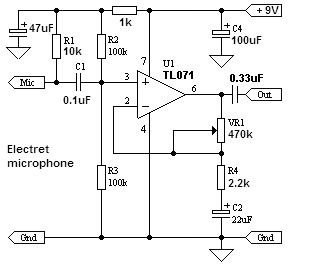

Aw, you guys made me draw a schematic. It was the usual stuff you know.
It's powered from a 9V PSU (7809).
Analog electronics is not my forte, so here is the schematic.
The input is twin wire unshielded, but the mic is 6'' away from the opamp input.
The output is a moulded stereo jack cable, the usual stuff.
Op amp is not decoupled (the input power supply is suitably bypassed) and the pins shown not connected in the schematic are not connected.
The schematic is truly the "true picture" of what I have... maybe I got some resistor values wrong from what it really is in my build, but I will have a closer look in the morning.

I'd try removing the 9V power supply connection from between the input and the input cap. Seems to me that any ripple on the supply will also be amplified and, if it's full-wave rectified, that would make it 120Hz--which might sound a lot like an air conditioner.
Simple idea to test and prove or disprove one way or the other, at any rate.
Torben
The opamp is inverting with an input impedance that is so low that it shorts the signal from the mic. The opamp should be non-inverting with a high input impedance.
The 1k resistor that powers the mic injects noise from the power supply that is amplified by the opamp. This resistor should be 10k and be decoupled with a 1k resistor in series from the supply and a 47uf capacitor to ground as a filter.
The mic is low level so should be connected to the preamp with shielded audio cable.
We are guessing that the noise is hiss or is hum. What is it?

What voltage is the transformer, the value of the filter capacitor and is the bridge rectifier half or full wave?
The LM7809 might be behaving erratically, if the input voltage isn't high enough.

Hum comes from the power supply or through the air to unshielded low-level wires.
gain of 100, and going into what is already a mic preamp in the computer........ going with a much higher value input resistor, or going with a noninverting amp would be a good start. knock the gain down to more like 10. also if you stay with the inverting amp, bypass those 47k resistors with a couple of 1uf or higher caps. you could be amplifying thermal noise from the 47k resistors, which will definitely add to the noise. you are probably also amplifying noise from the 7809.... is the 7809 properly bypassed with 10uf caps? i've seen 78xx regulators get noisy when the bypass caps dry out, because the regulator is primarily an "amplified zener", and the zener used as a voltage reference inside them creates a fair amount of noise, which is one of the reasons for adding the bypass caps at the input and output of the regulator. so you actually have several sources of noise here. the regulator and the voltage divider for the noninverting input you can do something about with a few electrolytic caps, but you can't do much about the input transistors of the op amp. an LF351 is (compared to a 741) a low noise device, but there are other devices out there that put the LF351 to shame. cutting the gain down to 10 rather than 100 will reduce the noise quite a bit. from what i see you're using an electret with a built-in jfet preamp (which is the only reason you would feed it with DC), so you really don't need a gain of 100 anyway. your PC input also has a mic preamp, so a gain of 100 stage before a mic preamp is going to be very noisy. go with a gain of 10 (replace the 1k resistor with a 10k), and if you want it to be variable gain (not neccesary, just adds a bit of flexibility to the circuit), replace the 100k resistor with a 100k pot. that way if you find a gain of 10 too much, you can turn it down from there.

The gain would be 100 if the microphone has a very low impedance. But the impedance of the mic is about 4.7k ohms which is in parallel with the 1k resistor that powers it. So 4.7k//1k= 767 ohms which is in series with the 1k input resistor of the opamp. So the gain is 100k/1767= 56.6.

Only the bottom 47k resistor should be bypassed.
No.
The FET is an impedance converter and has no gain. The output of an electret mic is very low and needs a preamp with a gain of 100 or more.
