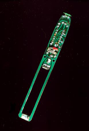

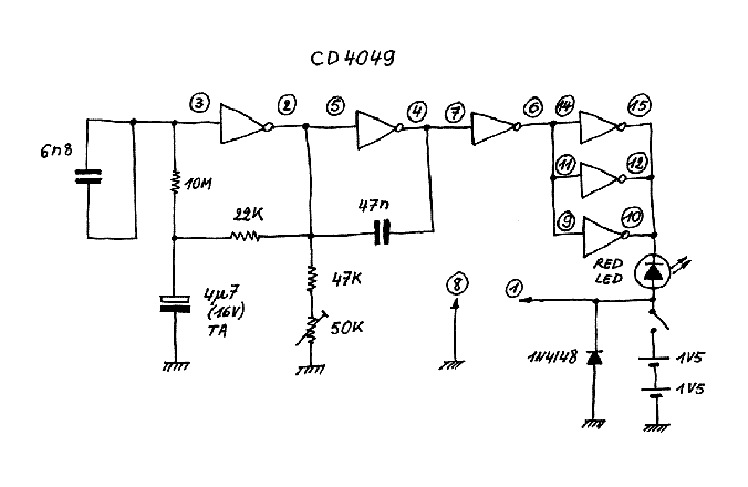

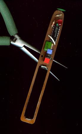

Mysterious sensor.
Hi Tony,
The mystery is solved, the sensor is nothing more than a 6n8
ceramic capacitor.
on1aag.

Hi
Can you tell me a little more about the theory behind the circuit, how does the Capacitor sense the presence of the supply
The capacitor is just an antenna. You could use a piece of copper. A metal button will work.
If you hold a metal frying pan close to an AC wire some energy will be transferred into the pan. (antenna)
