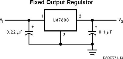

non-polarized cap insted of polarized one
SupeR-NovA
can i replace the capacitors for non-polarized ones?

thank you
