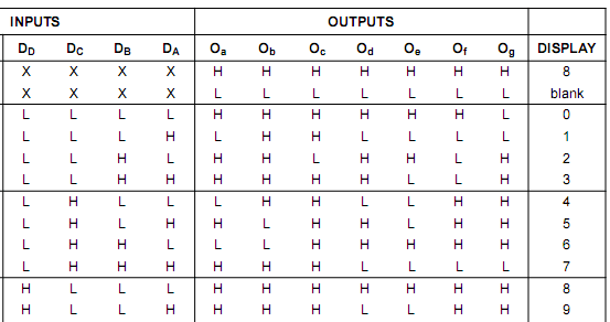

The 7 segments of a display are 'named' a,b,c,d,e,f,g.
The 'a' seg is the top segment, then counting clockwise b,c,d,e,f.... the g seg is the centre segment.
So write out 10 columns of 7 segments showing when the seg is lit as a '1' and not lit as a '0'.
So start your columns at column "0" BCD
this one will be the BCD number zero "0", the next column will be "1" and so on.
    "0"  "1"   "2"  "3" ... so on to "9"
a   1     0
b   1     1
c   1     1
d   1     0
e   1     0
f   1     0
g   0     0
Do you follow this part, so far.?
but 7segments binary code, have 128 meanings.am i right?.....2^7=128...
It is not binary, if it was you would be correct.:)
Its a 7 segment code, look at these images.
OK.?
EDIT: are you confusing 'segments' with 'bits'.???

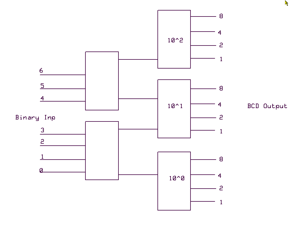

OR is this what you are trying to do.:confused:
i need to do this:
input output
1 0000001 to 0001
128 1000000 to 0001 0010 1000
i need to do this:
input output
1 0000001 to 0001
So its the last block diagram I posted: 7 bit binary to 3 digit BCD conversion.

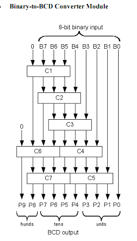

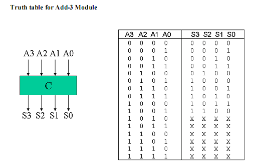

What you have to do is to make 7 of the "C" modules, all the "C" modules are exactly the same. See image #1.
Look at the module truth table, this is the logic block you have to design, its not easy.
When you have the 7 "C" modules connect them as image #2.
