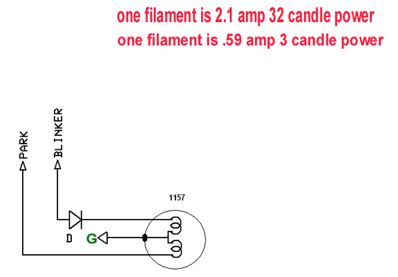

what bulb are you using (type or number) here is a common bulb use in older american cars (1157) . here is my circuit idea.

I'm leaning on the left diagram as the diode would be much easier to stick back in the fender rather than the relay. So far i got 1n4001 diode and 10w/10Ω ceramic resistors. Will install them once i get the time.
I have no idea what bulb type or # this is. The automotive shop calls them peanut bulbs. They are small (half an inch length, quarter inch diameter) single filament. The dual-filament bulbs available are much bigger and wont fit. I wish they mnade them this small though. Would save me the hassle of all the components... :D
