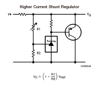

I want to make a charger to stay in my boat i have a solar panel 12-15volt to keep the batt topped off and over winter i want to plug in some wall wart to keep it topped off. Also maybe in the future add some wind power. Did not want some big complex circuit maybe some IC that can do most of it.
**broken link removed** is what I use. One regulator, three different power sources. Shunt regulator means no headroom above the battery float voltage is required. Ideal float voltage for flooded-cell lead acid battery is ~12.9 to 13.1V. Float voltage should be adjusted for ambient temperature, either a pot, or automatically with a thermistor.
I checked out the PDF for LM431 is one of the "typical applications" in the pdf what you are talking about? Also any good example circuits or reading you can point to?
Yes, this one:
And, of course, the shunt transistor has to dissipate the maximum power that any of the charging sources can generate, so will likely require a power transistor on a heat sink.
The solar panel I am using puts out a maximum of ~250mA at 14V, so the max dissipation is ~4W, which doesn't require a very large heatsink. I found a wall wart which puts out ~300mA @ 14V, so when I want to float the batteries when I have AC available, I substitute the wall-wart for the solar panel.

You need a battery charger circuit and you need a solar panel and a wall-wart with enough voltage to feed it.
If you connect a DC wall-wart to a battery that needs charging then without anything to limit the current the overloaded wall-wart will blow up or catch on fire.
Your solar panel will have its max output current for only one hour per day. It might take weeks for it to charge a dead battery.
No. By design, wall-warts have pretty loose coupling between the primary winding and the secondary winding (gap in the core?). As part of the UL and CSA certification they have to prove that they can be overloaded without catching fire...:D I have used the one I described for years and it doesn't get particularly hot.

So when is my wall-wart overloaded? The wall-wart I am using is rated to deliver 500ma@12VDC (6W). Its (unregulated) output current naturally falls off to ~300mA at 13V(4W), <50mA@14V (0.7W), and its open-circuit voltage is ~15V.
The shunt regulator is set to 13V, so the total wall-wart current is 300mA, about 250mA of which flows to ground through the shunt regulator, the other 50mA into the battery. This is the typical 99%-of-the-time situation
Even if the battery were mostly discharged, as indicated by an open circuit voltage of ~12.0V, the wall-wart would only deliver 100% its rated output of 500mA, all of which is initially going into the battery. The shunt regulator does not begin shunting any wall-wart current to ground until the battery reaches a terminal voltage of just under 13V at which point, the wall-wart is delivering 75% of its rated output.
