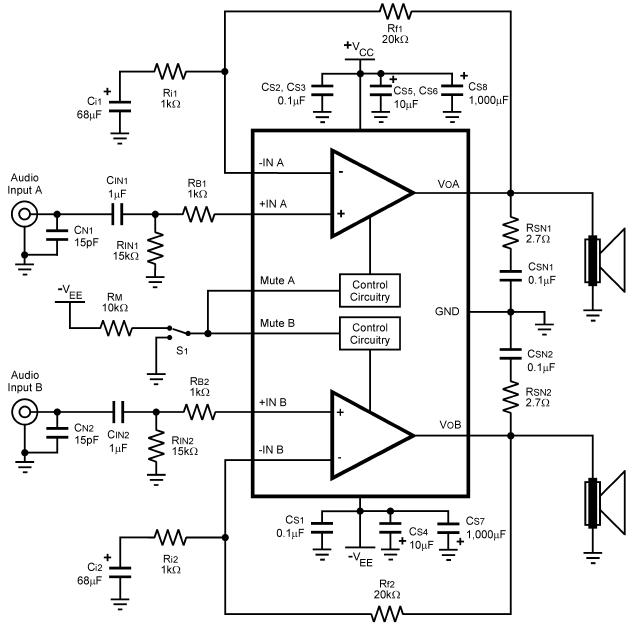

Im working with an IC chip lm4780 which is stereo 60w (per channel). I've followed the schematic provided by the data sheet , just i still cannot make it work. I'm using a bench top power supply testing between 25v-30v and on connection theres a little spark and some oscilation coming from speakers then after 1second it stops and only draws 0.01A.
I beilieve it's my ground. then 2 pins labelled gnd, should i connect them to negative??
thankyou attached is schematic
As Nigel stated, (and also the data sheet) you need another power supply. -VEE should be a negative voltage equal to the positive voltage applied to +VCC. The common point of the two power supplies are connected to all points with the GND symbol.

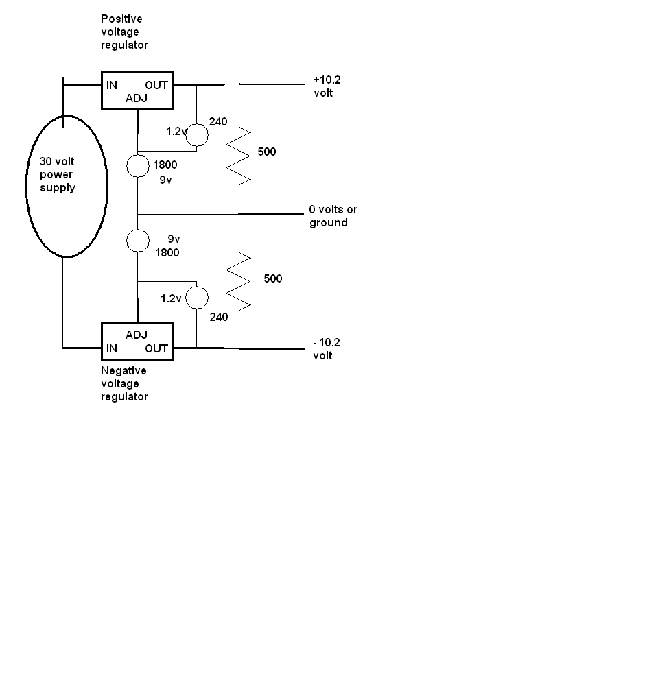

other than it may not be able to handle 60 watts per speaker, would this work for noob's circuit?

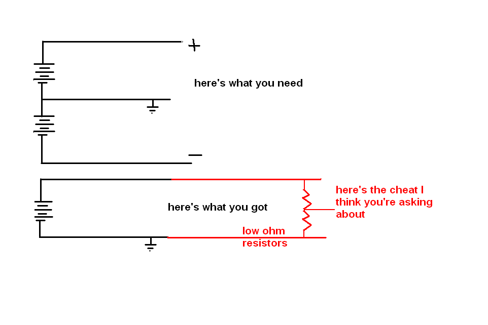

any ideas on any way around this, using my benchtop power supply, i heard someonewere you can make a ground from a single power supply using some components? diagram would be appreciated.
Using the cheat in this drawing burns lots of power and would be totally unsuitable to you needs. My previous post my work, but I haven't tried it yet, did something similar years ago. Hoping for a comment about it from someone out there.

This cheat won't work for a high power amp. It is only useful for something which has equal loads on both the positive and negative rails. Otherwise the Ground will shift with respect to Vcc and Vee causing noise and other problems.
The best solution is to build a dual power supply. This only requires a centre tapped transformer, a bridge rectified and a couple of large filter caps.
Figure 4 in the data sheet shows a single power supply hookup. But that's for the stereo (two amp) connection, not the bridged single speaker connection that the op showed.

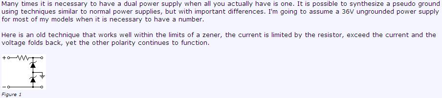

open the below attachment. Would this do the trick?
what specs would the zeners need to be if running at 25-30v?

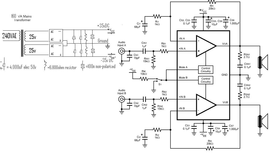

Ok i've wired everything up and connected everything as shown in the schematic.......and BANNNNGGGGGGGGGGGGG!!!!!!!!!!!!!!!! one of the 10uf caps blow up connecting negative to ground then the 1000uf cap opens from the top with THICK white smoke filling up my workroom/brothers bedroom, i disconect power open window close door and run.
Why in the schematic does it have caps running from -ve to ground the wrong polarity? Ground is the reference point and -vee is 30v below that so -vee is more negative then ground????
Anyways i installed another temporay capacitor (only 100uf elec) the right way around, and for a laugh id check if anything would happencif i re-applied power (seeing how much trouble/damage this circuit has caused me). And funny enough another BAANNNNNNNNGGG!!!, but this bang was a good bang...it was the bang of music playing. couldnt believe my eyes....eyes. After everything thats happened it was still working, and the music loudness and quality are excellent.
It doesn't, assuming you're meaning Cs4 and Cs7?, they are clearly shown -ve to -ve, and +ve to chassis/ground.
That's the whole point of a split supply.
i've connected it to the grounding of my toroidal, i though thats what i was mean't to do.
Below i've drawn a ROUGH schematic ive my setup of my toridal to rectifing to connecting it to the circuit.
Could you please look over it and suggest what you think?
