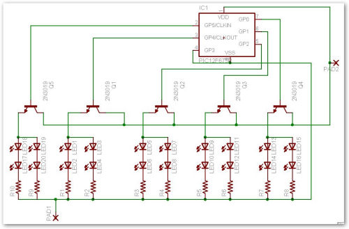

Guys-
I didn't mean to open a can of worms here!
I would be perfectly satisfied with 1 LED driver per output, or mutiplexed.
attached is what I think will work for me.
I haven't looked at the datasheet for this particular pic, I just grabbed an 8 pin at random. I could just as easily grabbed an ATtiny for this example. I purposely didn't complete the diagram, and won't until I check the datasheets on a few.
What I need to know is if I'm on the right track or not.
That's fine, depending what you want to do - however, it's usually far better to have the LED's fed from the collector of the transistor (much less loss), with resistors feeding the bases.
But is five outputs all you're wanting?.
That was just an example of what I want. I will probably do more. I am thinking of a relatively long light bar with 15 of those 4 LED sections, and program the pic with two inputs, one for left turn and one for right, controlled by an SPDT switch. Will have to put a "debounce" circuit on each input, might use 555 monostable for that. Unless I can figure out how to use a logic gate for that.
The whole point of micro-controllers is to make your design simple, cheap, and far more effective. You don't need to add extra devices to de-bounce switches, you do it in the software. To reduce I/O requirements, for 15 LED's multiplexing would probably be a good idea - details for 64 LED's are in my PIC tutorials.
