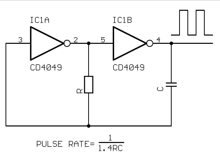

For the following circuit I have some questions:
(1) Is this oscillator?
(2) Does it work on the battery voltage (5v DC) Or needs to i/p signal for trigger?
(3) How the freq of oscillation can be calculated?
Thank you alot
No, it will not oscillate. It needs to have three gates. Here is a definitive reference.
Also R7 doesn't have to be connected to ground.
If R7 isn't connected to 0V then it might as well not be there.
It's possible to make an oscillator with two gates but it isn't stable at high frequencies but if all you want to do is flash an LED or make a piezo transducer go beep, it'll be fine.
The circuit you posted is wrong, here's the correct way of doing it.
What's wrong with that circuit?
R isn't connected to ground.

There's nothing wrong with that circuit, it's just totally different to the original poster's which wouldn't work and removing the R7 0V connection would've effectively remove R7 from the circuit.

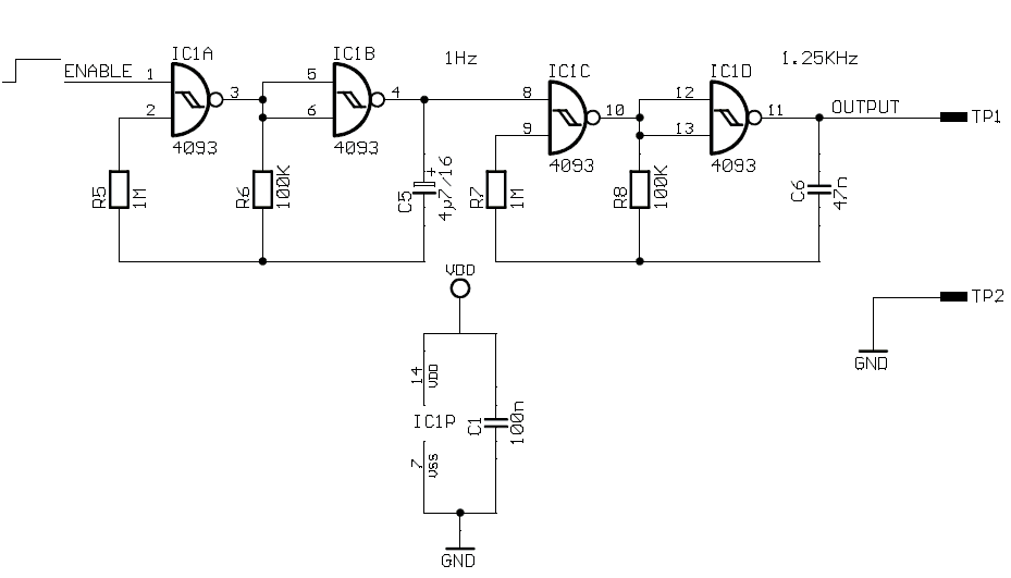

Hi walid66,
here is a circuit "beep-beeping" every second.
Adjust frequencies to your requirements.
Boncuk

The circuit posted by the original power beeps when it picks up a high pitched sound.
The piezo transducer is used both as a microphone and a speaker.
Tr1 and Tr2 form an amplifier and bandpass filter to select the frequency of human whistling.
Gates 3 and 4 form a timer which enable the beeper when triggered by a whistle.
Gates 5 and 6 form a low frequency oscillator which disable the audio oscillator when the output is high.
Gates 1 and 2 form an audio frequency oscillator.
There must be a way to stop it from self triggering, i.e. when it's beeping it doesn't hear its own beep, I assume it detects a different frequency whistle than the sound it produces.
I understand that Tr1 and Tr2 form an amplifier, but how they form a bandpass filter? Can you please explain it.
The human whistling freq is about 1800 to 2100 Hz. I try it in a multisim program and it show a highpass filter!
Is T for the Timer = 1.1 R7*C7 = 1.1* 2.2* 1= 2.4 sec.
is the timer on for T sec then off?
Why that timer proceeded by D1? is it to pass the negative part of the voice signal?
This oscillator freq = 1/(1.4 R8 C8) = 1/(1.4*1*0.001)= 714 Hz

The two transistors have three low-value coupling capacitors which are a highpass filter and C6 is a lowpass filter. Both make a very simple bandpass filter.
The diodes allow another circuit to disable or enable the oscillator.
