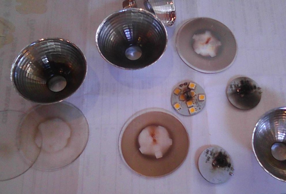

We got 140 of these from West Marine. 30 or more burnt the rectifier diodes and stunk and quit. At least 7 of them blew the 7 amp fuses. West Marine was good about replacing them. Some that were working okay were left on in a room with the A/C off. They got so hot that they melted the solder and the disk fell off its pins.

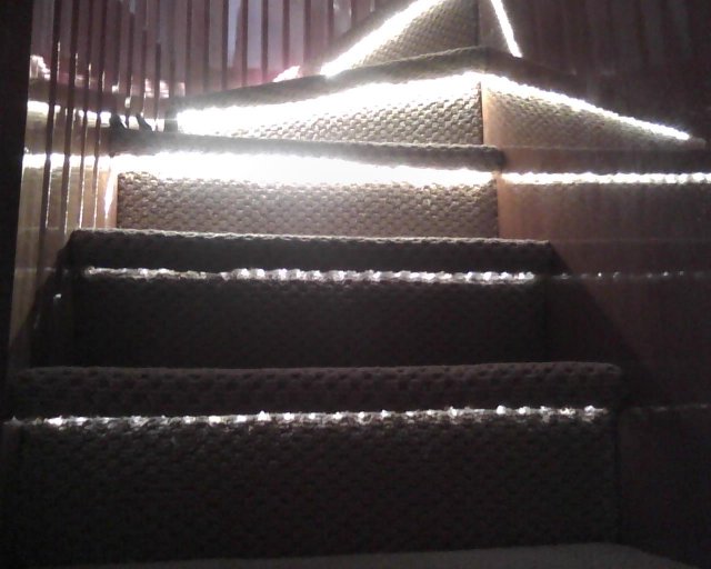

We got some 24 volt LED rope lights for under the stairs. I replaced the incandescent strings on 2 stairs. 3 months later, more incandescent strings went bad so I replaced the rest of them. With only occasional use, the LEDs that I had already replaced were a lot dimmer than the new ones from the same spool. So I replaced those 2 strings again and told the captain not to use them unless the owner was onboard.
