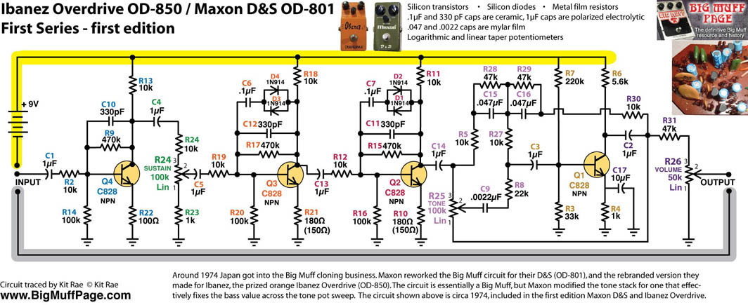

Hi. Newbie here. I need to replace a faulty NPN transistor in a guitar pedal. It's a mid 1970s C828 and 1 of 4. I have a modern replacement 2SC828 which appears compatible but on my DMM the hFE for the new one is about 300 and the older transistors around half that. So the question is whether modern equivalents are the same spec as older components? Thanks for any help.

Thanks for the replies. I replaced all 4 transistors and the hFE measured was typical for the old ones which were OK. However its still not fixed the problem. I have attached the circuit diagram. When R24 sustain is turned fully left, the pedal starts behaving like a tremolo unit. Overall it sounds very little like it used to, even with the 3 controls all up full. There's life Jim, but not as we know it........
I have tested each of the diodes and they seem OK. So I'm stumped now as that's all the most likely components replaced or tested

There are many electrolytic capacitors in there. They are low value, and modern designs would probably use ceramic capacitors.
It is highly likely that they will have all dried up, given the age of the device. Change them all.
What voltage is it running on? A near-dead battery could give that effect.

I'd agree on changing the caps, but never ceramics for audio coupling - they can introduce distortion.

D. There are seven 1.0 uF electrolytic caps (and one 10 uF e-cap). I am not usually a fan of wholesale replacement of parts, but in this case replacing these caps may be quicker and simpler than extensive toubleshooting using test equipment the OP may not have.
Note that if the capacitor convention of showing a straight line for the + lead and a curved line for the - lead is followed, C13 is shown backwards in the schematic. C13 + should go to Q3 collector. If you order replacement caps, stay with electrolytic caps and order an extra 10 uF. Install that extra 10 uF between the +9 volt power buss and ground, with the capacitors + terminal on power and the - term on ground.
If you wish us to help troubleshoot more deeply before you replace the caps, then with the unit operating, measure the voltages on each of the 3 pins of the 4 transistors (12 measurements), annotate them on the schematic and repost it.

The "tremolo" effect could be a description of motorboating, possibly from something modulating the battery voltage and upsetting the bias somewhere?
If you have a multimeter I'd re-check all the transistors in circuit (with power disconnected), to ensure the junctions are OK (reading as diodes from the base to the emitter or collector) and there are no emitter-collector shorts.

Thanks all. I should add that I have now put the original transistors back in place as the replacements made no difference. The end effect is the same. I've tried various batteries all with the same end result. Its a very good call with the caps. I have ordered direct replacements (electrolytics) and will seek to replace over the next week and get back to you. Thanks again.
I should add that I've had this pedal since new - bought it about 1976 or 77, so it is over 40 years old. It was working OK until a few months ago. Ageing capacitors is a very good call indeed and not one I would have thought of. Now if you've got a fix for the ageing owner of the pedal, I'd love to hear it.......
UPDATE. Just to say thanks very much for the excellent recommendation about the capacitors. Its taken me a while but that's all of them now replaced and the pedal sounds great ! So thanks again. I didn't add the large capacitor across the 9v supply, as there is very limited space inside the pedal. However I did add a 9v adaptor socket to allow connection to an external PSU. There is quite a hum when I connect the external 9v supply but lovely and quiet from battery. So would an extra capacitor help ?
