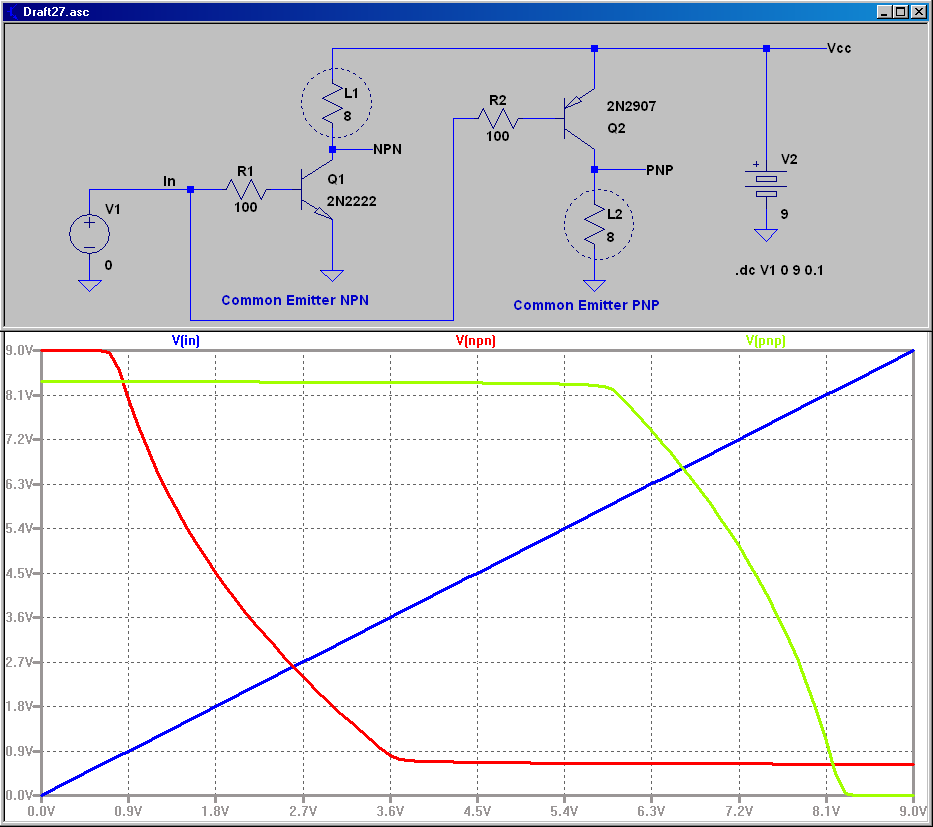

Sort of. Here is the voltage at the collector of a NPN and a PNP as the bases are connected through a 100Ω resistor to a voltage swept from 0V to 9V. The supply voltage is fixed at 9V. Note how the two transistors are wired. Note that the NPN turns on when its base is positive with respect to its emitter, while the PNP turns on when its base is negative with respect to its emitter.
And, as can be see from Mike ML's simulation, the normal positive to negative current flow is into the collector of an NPN and out of the collector of a PNP.
