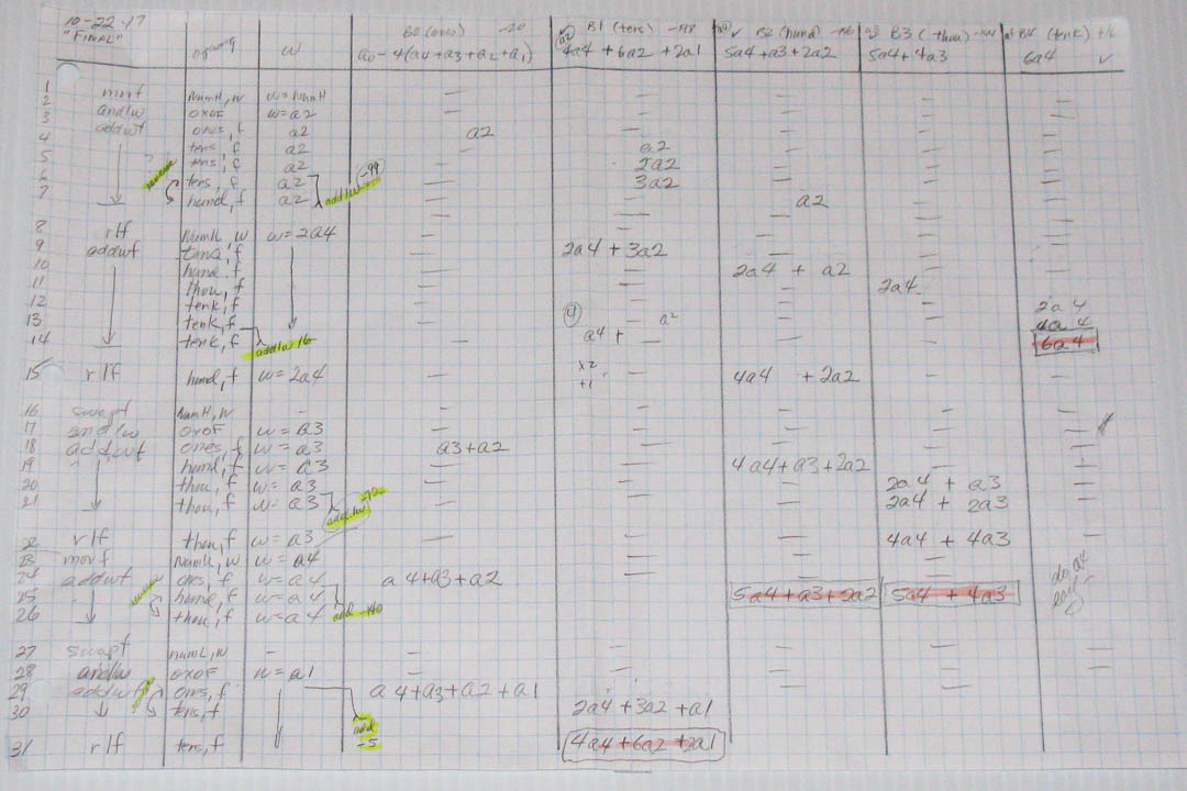

Sunday afternoons in Cleveland can be spent watching the Browns lose (0-7) or doing something just for fun. I chose the latter.
PicList has several programs for converting radix. One I particularly like for 16-bit to BCD is attributed to John Payson with refinements contributed by Scott Dattalo and others ( ). My "need" was prompted by a counter routine that prints a 5-digit decimal result. Of course, the display poops out at 65535, and it would be nice to scroll up to 99999.
I spent yesterday coding Mansheim's variation in MPASM along the lines of the Payson code, which combines isolation of the nibbles with calculation of the 5 registers needed: ones, tens, hund, thou, and tenK. My code works out to about 43 instructions prior to the "normalization" routine. Total Tcy for 0x1869F (dec 99999) was 312 Tcy.
I thought I would present it here for comments and improvements. Note that there ate two options for "DoA1". Option 1 is probably a little easier to understand, but destroys the binL register. Option 2 is from Payson/Dattalo and preserves the binL register. Steps are identical. One needs simple to comment out a "bra" to switch between the options. The majority of time is spent in "normalization" and suggestions for that wouldbe most helpful.
Regards, John
EDIT: I am not real happy with the way I handled a4 and may take another look at it.

Since you asked (before seeing the formulas), here's the spreadsheet:
For something like this I revert to the good old days when you could doodle while thinking. I also like to put it down for a day or two, them come back fresh. I will play with it a little more today. Since the register in those formulas that supplies tenK is either 1 or 0, I may try to incorporate that in cleaning up the routine.
Thanks for the interest.
John
UPDATE
Due to several small errors and the difficulty of maintaining code in several places, the "final" working code has been posted here:
Playing with this equation is a great way to waste time, and 3:30 PM was just not coming fast enough (Penn State v. Ohio State).
So, realizing I had changed the additions and only one of the "magic" negating numbers gets doubled, I calculated a newer set that reduced the number of cycles in normalization. That trimmed 10 Tcy from the whole process.
The new "magic" numbers are:
;ones= -20 , carry=2 (same as original)
;tens= -128, carry=13(-64x2)
;hund= -57 , carry=7
;thou= -73 , carry=8
;tenK= +8
Simply plug those into version 3.1 (Post #11) appropriately and it should work.
John

Hi Bob,
I have not run Les' code. It is for 24 bit, so any comparison might be a bit biased against it. I did run a version of Double Dabble from Microchip's forum that was posted by 1and0 here: https://www.microchip.com/forums/m853241.aspx
Run time for a 16-bit was 344 Tcy, but that also includes doing the ascii offset. My notes indicate that the same number with the Payson polynomial was 183 Tcy. As seems to be typical, looping methods favor shorter code but longer run time. I suspect successive subtractions would follow that pattern.
Going back to the original Payson method, I think that can be tweaked a little by changing the negative offsets as I did in post #12. Here's a table showing what I did for that post:
I would look first at the offset used for the 10's, which probably affects the later ones as well.
Regards, John
NB: I was a little worried about the offset used for b2 as it is the only instance in which the absolute value of the offset is not greater than the maximum value of the digit's polynomial with carry. I evaluated several inputs to test whether that caused an error, and they all worked fine. Of course the polynomial is negative and the apparent "inadequate" compensation for carry is taken care of in b3 .
