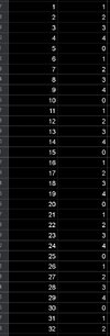

I'm struggling with Google Sheets on my phone (since I should be asleep!) so it's not too polished. I did MOD (X, 5) over the range from 1 to 255 (without adding 1 to every value to offset from Zero) and the resultant pattern is:
1
2
3
4
0
1
2
3
4
0
with a totally uniform distribution. The randomness of the method comes from a human triggering an event, so I believe there would be no bias to any particular number.

Does modulo affect a random distribution? I demonstrated that using %8 on a random distribution of values between 0 and 9 can . A random distribution should have an equal probability that a subsequent number will be any of the in-range numbers, including the number itself. Modulo 8 increases the proportion/likelihood that the next number will be a 0 or 1.
Effectively, the probability of 0 or 1 is doubled compared to to the probability of digits 2 through 7. Deleting any value more than 7 doesn't cause that change; although, the probability for each number is increased by the same amount., i.e., 1 in 8 rather than 1 in 10. Discarding values out of range is easy code, but not as simple a masking.

If the extremely tiny error (20% chance of some values (of a set of 5) vs. 20.008% chance of other values being generated) is too large for your taste, the solution is trivial. Simply throw away whatever few values at the upper bound exceed the integer number of sets of N (5 in this case).
Timer range = 2^16 = 65,536
Complete sets of N values = 65,536/N = 65536/5 = 13107.2 so there are 13107 complete sets with a remainder of 0.2. If my brain is working correctly, that means we need to throw out the highest value to get an integer number of complete sets:
65,535/5 = 13,107.
So adding a single IF/THEN totally fixes the possible distribution error.
