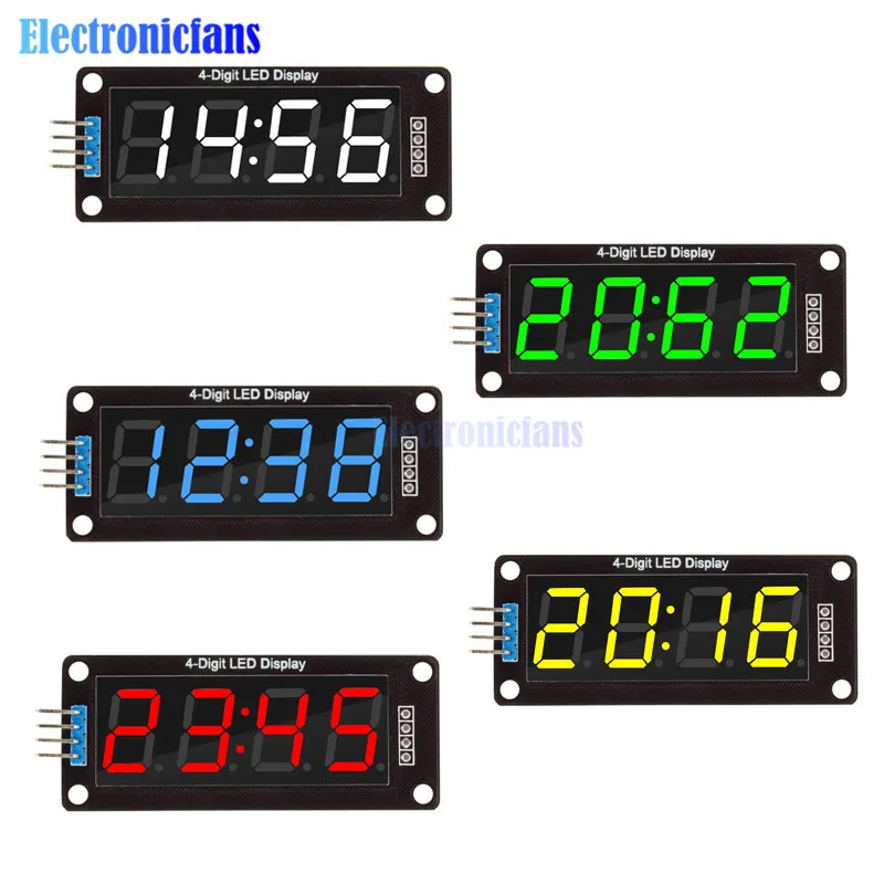

Are you locked into the 74LS47? A display driver chip like the TM1637 will drive up to 6 common anode displays using a 2-pin interface (CLK & DIO) and it handles display refresh. It's available in a DIP-20 or SOP20 package. You can get 5 chips for a couple bucks from AliExpress vendors or 4-digit 0.56" modules for about $3 (including shipping).

Mike - K8LH , I like those displays, played with some max7219 driven displays but 8 digits is normally too much. Four is perfect.
Edit, I note they have both the DP and the colon LEDs - are these all controllable?
