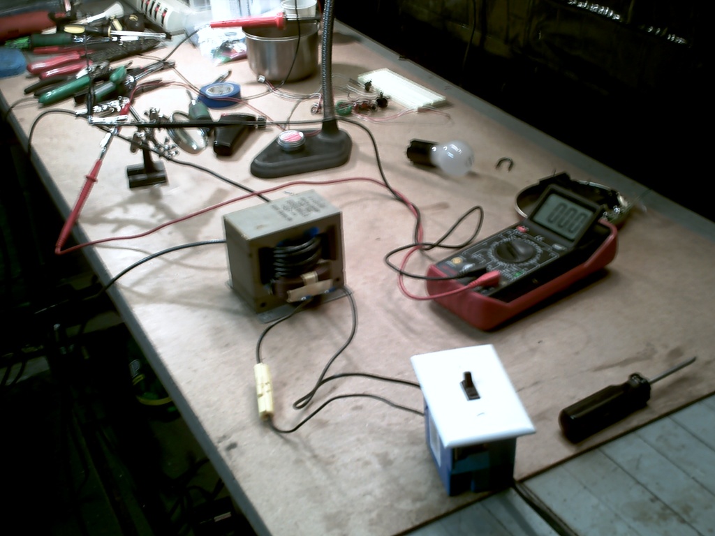

I am going to try and work on this transformer situation in reverse. I've got the HV secondary winding from a MOT already removed. I just wrapped 11 turns of #10 wire on it. I am going to run a 6a fuse in series on the primary because I read somewhere that you cannot rewind a single MOT without a load. Supposidly the MOT designers knew that these MOTs would always have a load on them (the magnaton) so they purposely used less primary windings. If I blow the fuse then I'll know they are correct. They recommend using two MOTs in series that is supposed to rectify this problem. I will somehow have to calculate the turns ratio in order to find out the primary output(?). I want to see what voltage I will get out of my secondary side with the 11 turns.

Don't really know, but, I just tried out my rewind, 19 turns on secondary with #10 wire and got only 19.6vac out of it. Hooked up bridge and cap, got 27.7vdc. In my next experiment I will run 24vac into the secondary and see what comes out of the primary. If I have to, I will wind some more turns on the primary, but that will mean I need to take one of my MOTs apart for the wire (which involves grinding, cutting, etc)

I am working this tranformer problem in reverse. I cannot even know for sure whether the primary windings on this transformer are normal 115v because I have read that the designers of MOTs purposely used less windings then normal because they knew there would always be a load on them (ie the magatron), so, my next step, that I will attempt in a couple minutes, is to attach a 24vac source to the secondary and see what I'll get out of the primary.
My next move is going through all my transformers with a 24vac test.

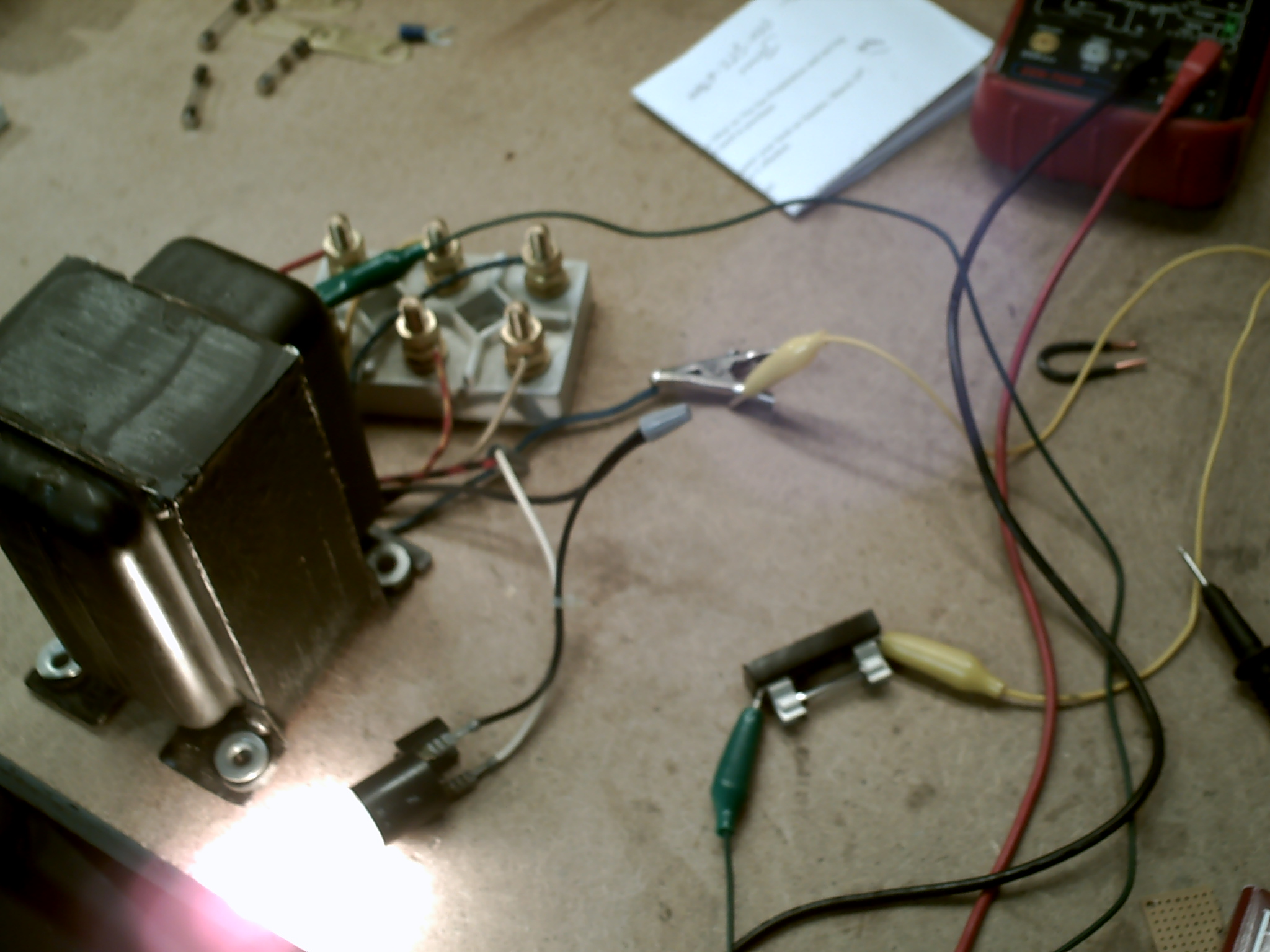

I think I may have found a transformer that might work on this project. I've hooked up the secondaries to 24vac and I'm getting 121vac (no load). I observed that my voltage goes down as I progressively use higher wattage bulbs as a load. My highest wattage is a 75 watt 130v bulb and my meter is reading 98vac. I'm not sure what this indicates. Smanches, you said I would probably need an output of 140vac; do you think 121vac will work? The transformer is out of an old television so I'm not sure of how much current it would handle and I really cannot test that with my test ac 24 volt supply. I only want 200 or 300 watts, if I can get it.
