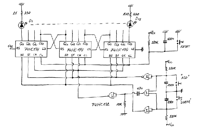

I am in the need to make a small thing that has a row of 10 lights (LEDs etc) and with 2 buttons and a speaker giving a tone when one of the buttons is pushed.
Button A would turn on one of those lights. hit the button again and it would add a second light and so on and so on, to a max of 10 lights. They would stack next to each other from left to right (from first light to the tenth light)
Button B would simply reverse the and take away the last light given to the order.
Maybe a 3rd button that would to just reset the lights (no matter how many lights are up). but not needed at all, just handy I guess.
Speaker would just give a beep or buzz or something each time the add a light button is pressed.
Here is a link to a diagram I did that kind of explains better what I am trying for. I hope it helps. https://images.elektroda.net/75_1179456614.jpg
Well if anyone know if this is a possible thing to make, can you let me know. I can then at least start to research it.

hi kevin,
If you are unable to go the PIC route, you could consider using a 74190 BCD UP/DOWN counter with parallel load option [ zero all third button].
The 74190 would drive a 74154, 4 to 16 decoder, on each output line '1 to 10' connect a led with a series resistor to +5V.
The '0' position would represent all OFF.
PB#3, all OFF
PB#1, INC 74190 up, PB#2 DEC 74190 down.
Use a 7414 hex schmitt to clean up the PB pushes and also use part to make a 1kHz tone generator, beep on push.
Perhaps another logic gate maybe required.
Does this help?
EDIT: A 74191 bin up/down counter would be a better choice, rather than the 74190.

kevin,
If you do decide to go the non PIC route, I was planning to send you a working drawing that would enable to start the project.
You say you can read a circuit diagram, no doubt you have the will and the tools/components to get the job done.
You say my suggestion didnt help, without wishing to sound 'picky' what do you want to know?? ....... Ask.

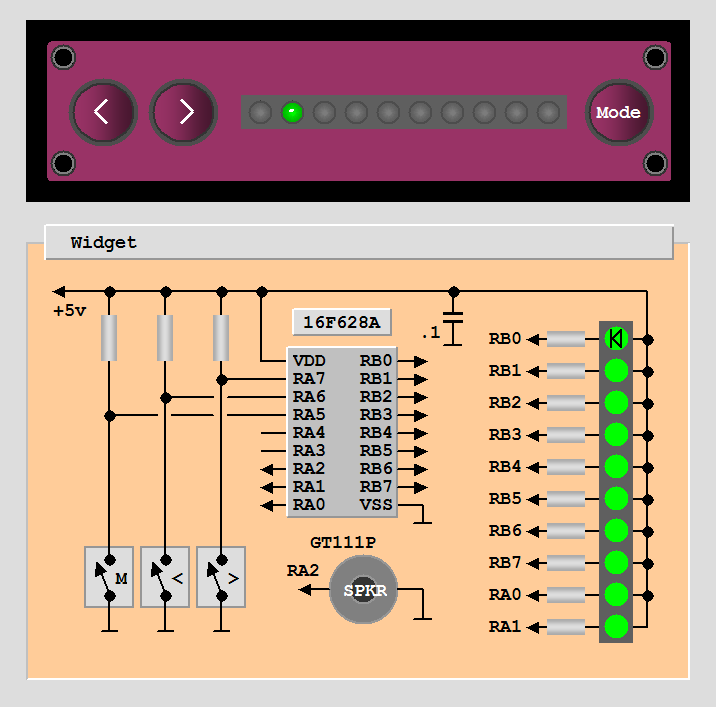

Actually, I would expect the PIC solution to use fewer components, since it contains almost everything needed--you do all the work in software and just stick a button, some LEDs, a buzzer, and a handful of resistors on it. (That's oversimplified but not by a whole lot). Then you just write up some code which says essentially "if Button A was pressed, then beep and light another LED; if Button B was pressed, then beep and unlight the last LED lit".
The other way, you'd need at least a decade counter IC and some kind of latch setup to keep the correct LEDs lit.
Some reading which doesn't directly address your problem but which might be helpful: **broken link removed**
Last year I made my first digital circuit: a scoreboard for my foosball table, using the non-PIC way. It was fun, instructional, and if I had to do it again, I'd probably use a microcontroller like a PIC (or probably an 8051 since that's what I have a programmer for). My circuit would have probably one third the components, if that.
Note that if you use a PIC or other microcontroller you'll need a device to get the code onto it (a programmer), plus a "toolchain" (code editor, compiler/assembler) to prepare it.

A microcontroller solution would work well and your requirements are relatively simple;
(A) Software debounce with switch press beep.
(B) Switch press "repeat" capability?
(C) Modes; <1> Up/Down, <2> Night Rider, <3>???
Unfortunately the learning curve for microprocessor development can be quite steep.
Perhaps some kind soul might code it and burn it into a chip for you.
Kind regards, Mike
