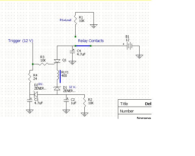

The pulse will be from a 12volt source...a relay closure. (specifically, the output from a VOX circuit. What I had drawn out, was having the pulse trigger an SCR, which would be connected in series with a zener (to provide a more reliable cutoff) and the relay coil. This line would charge a capacitor, instead of being grounded, and as the capacitor charged to a certain point, the zener would stop conducting, and which would cause the SCR to and the coil relay to drop out.

Ok..Im trying to upload a schematic of something I had in mind. It is attached as delayrelay.jpg.
When a 12 volt trigger is applied to the SCR, it begins to conduct, and immediately trips the relay, which begins to draw current from the C4 (sized to allow for 1-2 seconds of current. D1 provides a sharp, dependable cutoff for the relay. Anytime a pulse is present (it can be anywhere from .25 seconds or so to continous), it charges C3, which will prevent the relay from tripping for a set time period after the last pulse.

I don't think the relay will ever turn on - since D1 will never conduct any reasonable amount of current. Also, is 4.7uF enough to power a relay for 1-2 seconds? I'd guess that the you might be off by an order of magnitude (or two).
Any better ideas, even starting from scratch? One problem, is that the capacitor sizes need to be kept fairly small...this project is for automotive use, and I have to use either tantalum caps or automotive ones for vibration resistance.
I started drawing out a circuit, but then realized that it's easier to just "say the correct name" and point you to someone else's pretty pictures. In this case, the keyword is "monostable multivibrator" to generate the 1-2 second pulse.
If you want to just use transistors, https://en.wikipedia.org/wiki/Multivibrator has a monostable circuit - two transistors, 3 resistors and a capacitor, or alternatively a 555 based circuit would also work. (Just google for "555 monostable" and you'll hit a pile of links).
So that circuit will generate a consistent output pulse, and the only thing left to do is to figure out how to do the input side - as well as control the timeouts. Now there's one bit of confusion in the specification you gave - is it supposed to wait 5-10 seconds between the start of the pulse, or is it supposed to wait 5-10 seconds after the first pulse has gone low?

Choice B...I don't want the circuit to be able to fire again for 5-10 seconds after the last pulse has gone low. Initially, I thought I'd be able to make up a very simple circuit, the one that i posted, but I see its going to have to get just a little less simple. I'll post it when done, and maybe you can see what you think about it. THanks for all your help!!!

BTW, if that is the input functionality you need, then you will only need 1 capacitor, 3 resistors and a diode or two, in addition to the parts for the monostable pulse generator. (The other choice would require a little more thought...)
