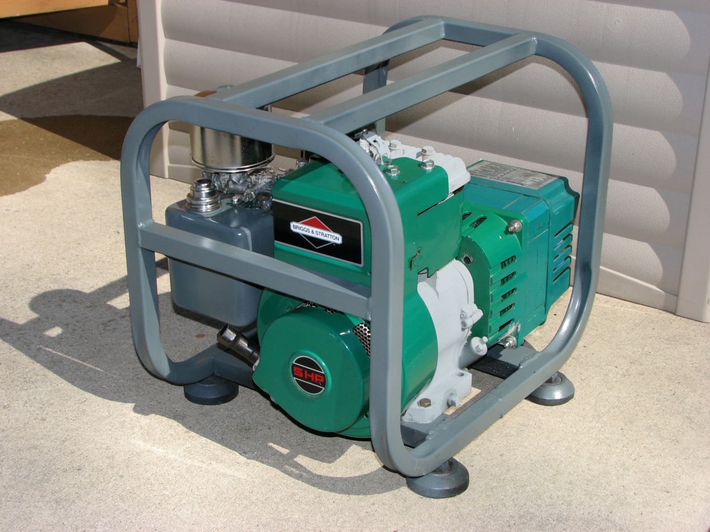

It sure didn't end like I wanted it to. I wanted to end up with a nice looking and good running Ag Tronic. As it is, I guess there's little doubt that I did all that I could do to ensure it wasn't repairable. No way will I pay for a rewind on a generator that is not collectible. As it sits, it's probably as good as it's going to get. Repair parts will be Powermate or Briggs and Stratton. And it does run really well.
Thanks for the interest! This has been a fun ride and you guys are really helpful. VERY much appreciated.
Generator Success!!
Gents - The old Ag Tronics engine is now spinning a later model Powermate Generator head. With the totally reworked generator working wonderfully, I now have a new question.
My dad wants the generator as a backup. He wanted to run a couple of lights so he and mom could play cards while they waited for the power to come back on. Then he wanted a refrigerator to run too. So far, no problem. Now he wants the furnace to run too. Hmmm. Digital thermostat. I don't know about that. And he wants the flat panel television also.
I can put a 4000 watt generator at his place but he's keeping this on the cheap so it'll be the older brushed type generator. There are two ways to determine what's going to happen when I plug him into the generator. The first is to just try it. I'll certainly have an answer pronto. But we may not like the results with the TV and the digital thermostats. The generator voltage is stable at 117 - 123v depending on the load. The frequency is 59.5hz - 60.5hz. I don't have a scope so I don't know what the condition of the sine wave is. I'm looking for a reasonable test. I've heard that simple computer backup power supplies are fairly fussy about their power - too dirty and they won't operate. I could try that on the assumption that the TV will work if the UPS works. I could plug in a CRT TV and if the picture is decent it should be OK. Are those valid tests? Got a better idea? He won't buy a UPS to condition the power for the television.
If you're thinkin', I'm listenin'. Here's a photo of the finished generator project.

The only thing I think you could have a problem with is a timer that relies on the mains frequency as a reference in which case, nothing bad will happen, it just won't keep good time..
Most modern electroincs should be fine because the use SMPSes which ware regulated and can work from a wide range of voltages. AC motors such as the type found in a fridge need a sinusoidal waveform to work which won't be a problem because it's what the generator will produce.
Before I forget, great picture. Came out really looking great!

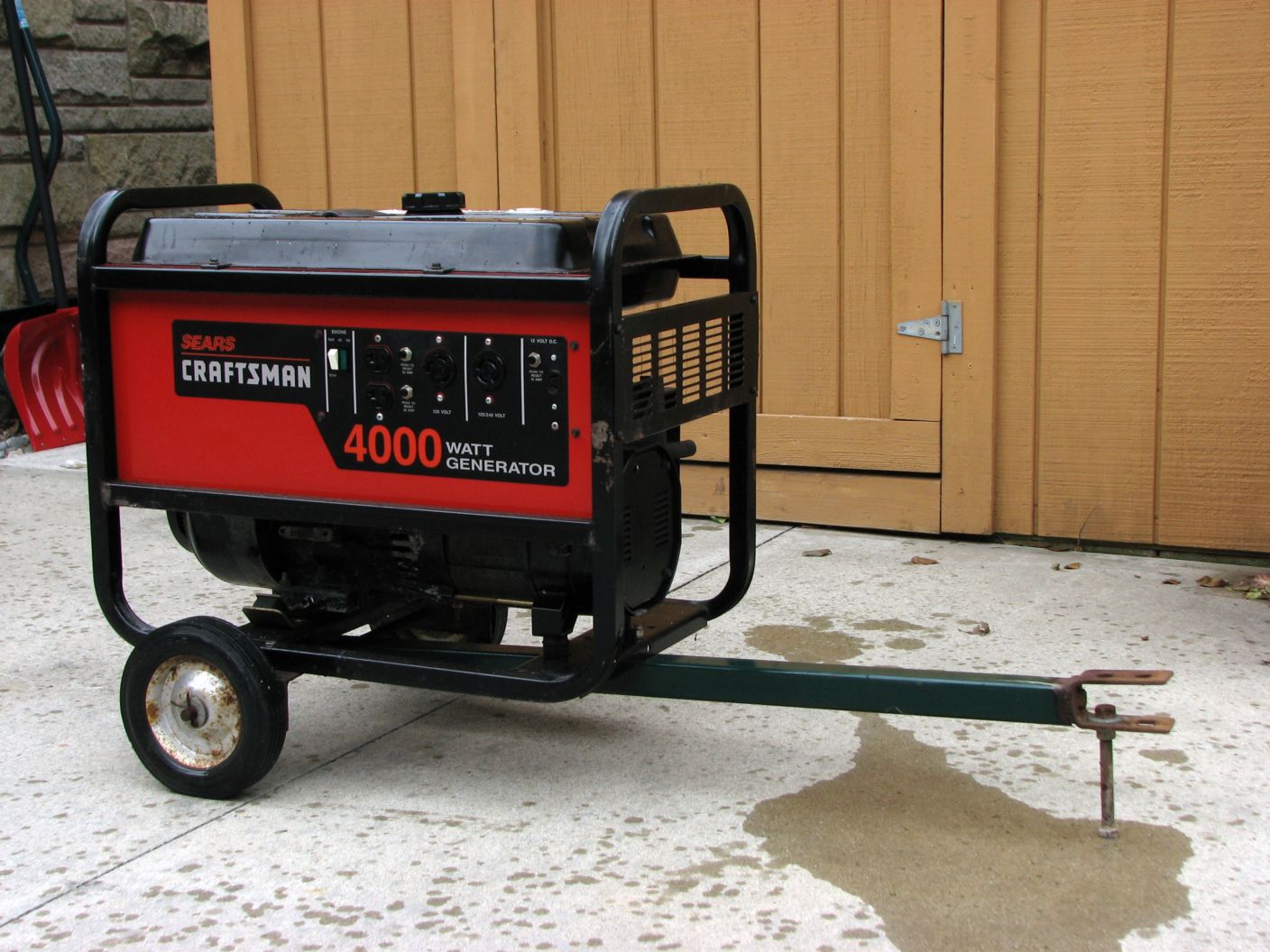

You're right here for me again, guys. Thanks. The folks balked at getting the new TV's but now that the new sets are in service I sure didn't want to fry a new television by using a generator. I was looking for a gut feel about hooking new electronic stuff to an old generator. 12 years old. That's like - 1998. Is that old?
I included a photo of the unit that is going to Dad's. It runs a LOT quieter than the Powermate and it has a 4 gallon gas tank. It's a 4kw Generac/Tecumseh 8hp unit. I believe it's a full wave rectifier like my 2.4kw Generac - and it's certainly brushed. I expect that it's easily the equivalent of a Powermate as far as waveform quality. I don't know if the 4kw rating is max or running output but they live pretty simply and they understand emergency situations so they'll keep the power load down.

I would venture a guess that the 4 KW rating is the output with a surge rating around 5 KW for short periods like when a motor starts. Nice is where I originally screwed up with fuel tank capacity. Four gallons should keep it running for several hours and much more under lighter loads.
Don't know if it holds true on this unit but Sears is good about online manuals so with an exact part/model number you can likely get a manual.
Additionally guessing from the image it looks to have a 240 VAC outlet which makes for cool if you want to set up a pony point where it can be directly connected to the mains supporting the house. Obviously not connecting directly into the mains! But a system to allow the unit to be dragged out and connected once the mains breakers have been turned off and back feed into the main circuit breaker panel through breakers.
As to age? More a matter of actual runtime. A ten or twelve year old unit with little run time in hours is as good as a new unit. You saw from your initial project that the guts don't change much. A unit with lower runtime that has seen good maintenance (regular lube, oil and filter with good quality oil) should perform every bit as well as a new unit.

Ya really think it might be a 4k with a heavier surge? Thinking about it, that may be. I have a 2.4k generac and this 4kw is easily twice the size. Sounds reasonable. And the 8 hp engine supports the idea that it is a 4kw constant output.
Fuel Tank - the larger tank size was a selling point. And the large fill opening is way better than trying to pour gas into the small tank under the air filter. So far I've had no luck finding a manual. I do have the model number but the Sears site isn't connecting it to anything.
It does have a 20A duplex, a 3 blade 120v for boats and RV's and a 4 blade 240. Another good selling feature.
